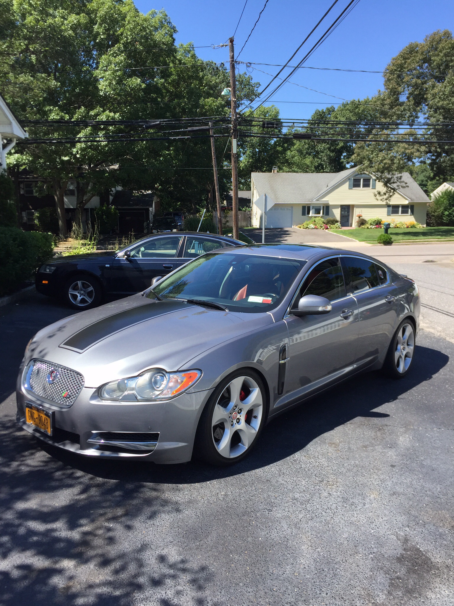

Not the best pic...but gives you an idea. Springs and Spacers make a nice fit....no issues .
Attached Thumbnails Does anyone have Mina Gallery springs installed?-image.jpg

You car looks great! Any chance I could request a side shot? What size spacers did you go with?
Thanks again!

Car looks very sharp,awesome stance! What size spacers?
