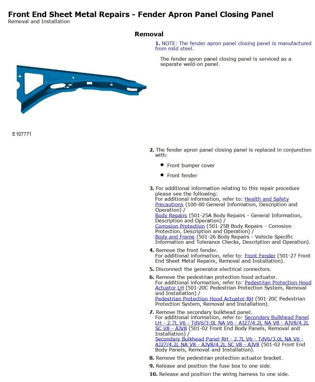

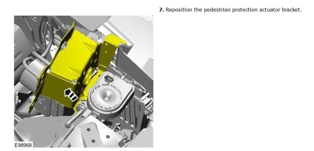

I don't think it comes out easily, you normally just rotate it out of the way to get access to the ECM cover. Take out the 3 bolts on the ECM cover and the 2 on the ECM, then slide it out. But it doesn't look like the bracket itself comes off without dismantling a load of bits from the front of the car.
This is the only reference I can find to taking the bracket out, which seems to imply removing the bulkhead panel first so maybe its under there:

You're right, it does not come out easily, there's lot to dismantle first. I had to use a crowbar to move the bracket under the HCU out of the way. Luckily the bracket is quite springy. The manual is not helpful when it comes the the RHS actuator bracket. The LHS is uncomplicated. Thank you for taking the time to upload pictures.
