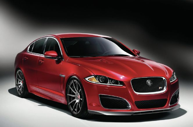

The article can be found at this link:
2012 Jaguar XFR - European Car Magazine
The Vorsteiner carbon elements look absolutely phenomenal and it seems that GSR Autosport has been able to create a one-off exhaust system for the car. I can't wait to see what their dyno numbers show!
Hopefully it gets good reviews when pitted against the new F10 M5 as well!

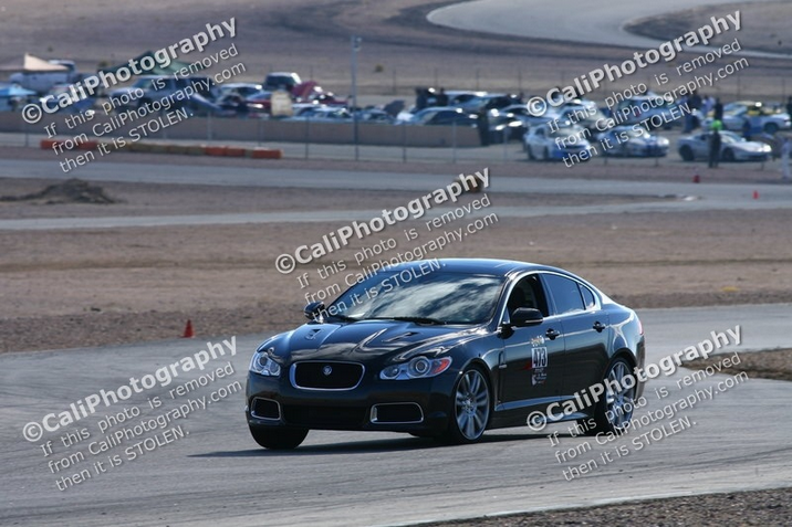

I am currently running the one-off axleback by GSR Autosport that was made for their test XFR in these articles. It is actually an excellent sounding system and there really is no drone while cruising at freeway speeds.
At wide open throttle, this axleback is actually quite loud; louder than many of the cars (as told to me by spectators) at the recent track day I attended at the Streets of Willow. The car was excellent on the track, however, there are a few areas in which it could use improvement. I probably should have ran the Michelin Pilot Super Sports rather than the very tame Hankook V12 Evo's.

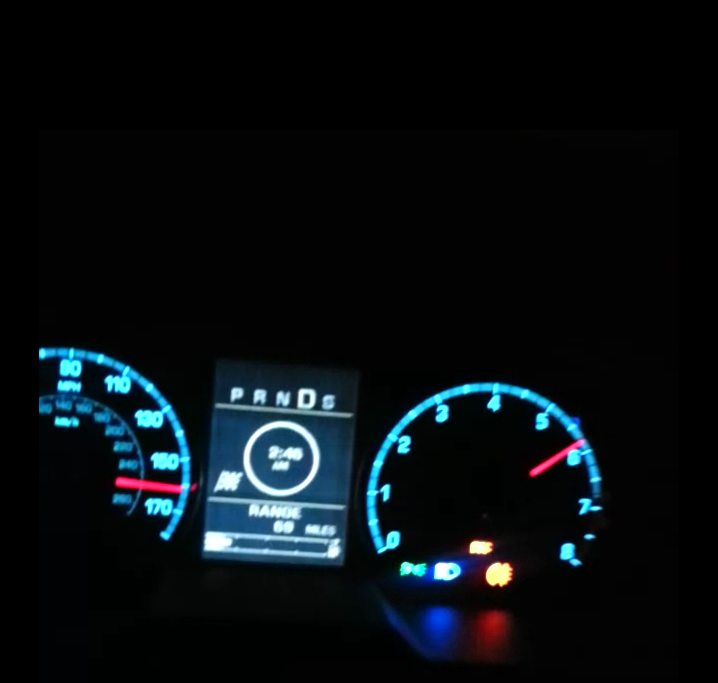

The service manager at my local dealership has agreed to flash the factory engine map from the XFR-S onto my car using IDS/SDD. We are currently researching if the TCU and Differential programming from the XKR-S GT can also be flashed onto my hardware. The reasoning behind my wanting this map is the fact that the XKR-S GT shares the same six speed transmission as my 2011 XFR and I am hoping this will raise the torque limitations for midrange power, raise the governor from the factory 162mph to 186mph, and make the active differential engage earlier to reduce the tendency for the inside tire to spin power away on corner exit.
I feel these flashes along with the pulley and exhaust should provide a safe yet tangible increase in power and performance.
