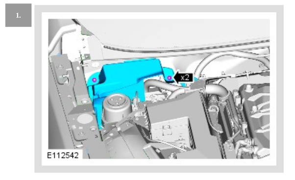

AHA.
This is almost certainly your problem. Sadly I can't get a picture of my own engine bay at the moment as I'm working on the hood, but there is supposed to be a cover over that hole, and if you don't fit it, water WILL leak into the cabin. I had this happen when I hadn't fitted the cover back.
That hole is the air intake for the cabin, so if you look inside you can see the cabin air filter. You are correct that this is changed from inside the car, but it draws its air from the area around the ECU. The hole is supposed to have a plastic cover that is head in place by two (from memory) 6mm nuts - when this cover is fitted the water from the windshield runs either side of the hole but when it's not water can get inside the car through this hole.
You can see this cover illustrated in the Workshop Manual Section for removing the R/H Secondary Bulkhead Panel:
If yours is missing the part number for this panel is C2D5394 and the part number for the nuts that hold it on is C2C22722. The OEM Trim Clips for the windscreen finisher panel are XR87508, of which you need 7. The 8th hole gets filled by one of the 3 clips that hold the fuse box cover on.

@davetibbs - thank you for that!!!!
That is the spot and yes, that cover is missing from my car . Funny enough, the nuts are in place - and this is what made me wonder originally what were those nuts suppose to hold in place.
Thank you for the part numbers - I will start looking for them online and see where I can find them.

LHD = Left Hand Drive = Steering Wheel on left side of the car.
In Canada that's the part you'll need. Here's a picture of it from an EPC parts site:
