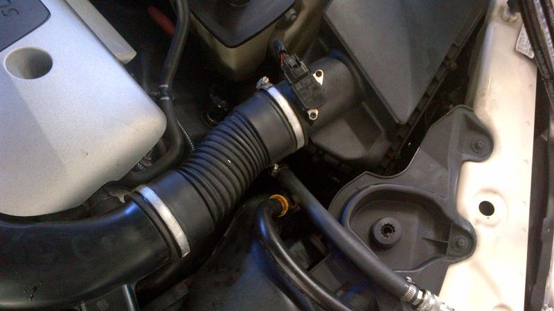

We had quite the debate on the forum here regarding transmission fluid, to replace or to not replace. For me it comes down to peace of mind for little cash outlay.
I went to my local garage and had them use their machines to replace the transmission fluid, power steering fluid, engine coolant and rear differential oil. Total cost was less than $520 USD.
To change the transmission fluid they tied into the top transmission oil cooler line at the radiator, 100% of the fluid was exchanged, simple no mess no fuss. We used BG full synthetic which meets ZF specs. See the pic below of the fluid coming out of the transmission and the new fluid going in, I'm sure you can tell which sight glass (upper or lower) is the old stuff.
To change the coolant they tied into the upper rad hose, no big deal, he flushed the whole system 3 times with the new fluid and had put in some chemical flush earlier which circulated while the car was running during the transmission fluid exchange.
The power steering fluid was exchanged by a machine as well.
The diff oil was sucked out of the fill hole and replaced, simple.
Brake fluid was done not long ago and the engine has fresh oil and filter.
Bottom line is that it was no big deal, not to expensive and in my book with 66,000 miles on the car a worthwhile endeavor.
