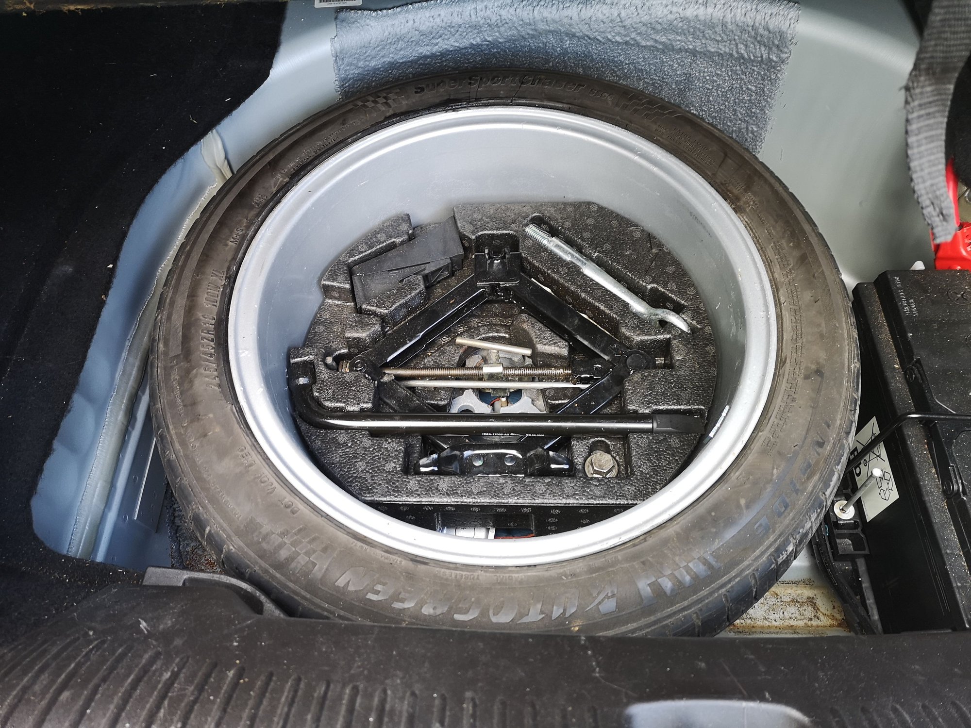

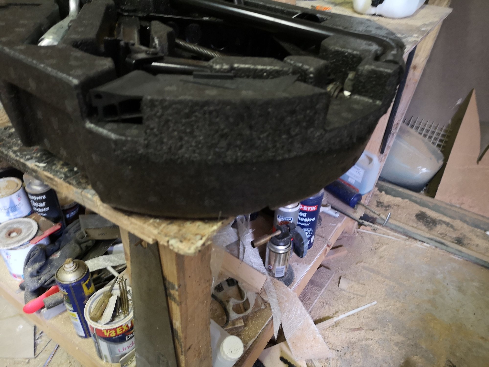

So, I got my replacement wheel, refurbished from a UK company, perfect condition, at a total cost of 124 pounds sterling, including postage to Ireland. No complaints! It fits perfectly into the wheel well in the boot and I even managed to trim the tool kit down to size to get it to fit inside the rim, so everything is as it was, all snug and secure, but with the right sized wheel. I trimmed the foam tool kit holder with a coping saw. It's like a fret saw if you're unfamiliar with such things, but a fine toothed bread knife will ddo the job just as well. I had to trim back as far as either end of the wheel brace, as seen in the picture, but at least it keeps things fairly original. The boot floor liner also fits back down perfectly without any humps. Thanks for the various responses. Now I just have to sort out my intermittent speaker!
