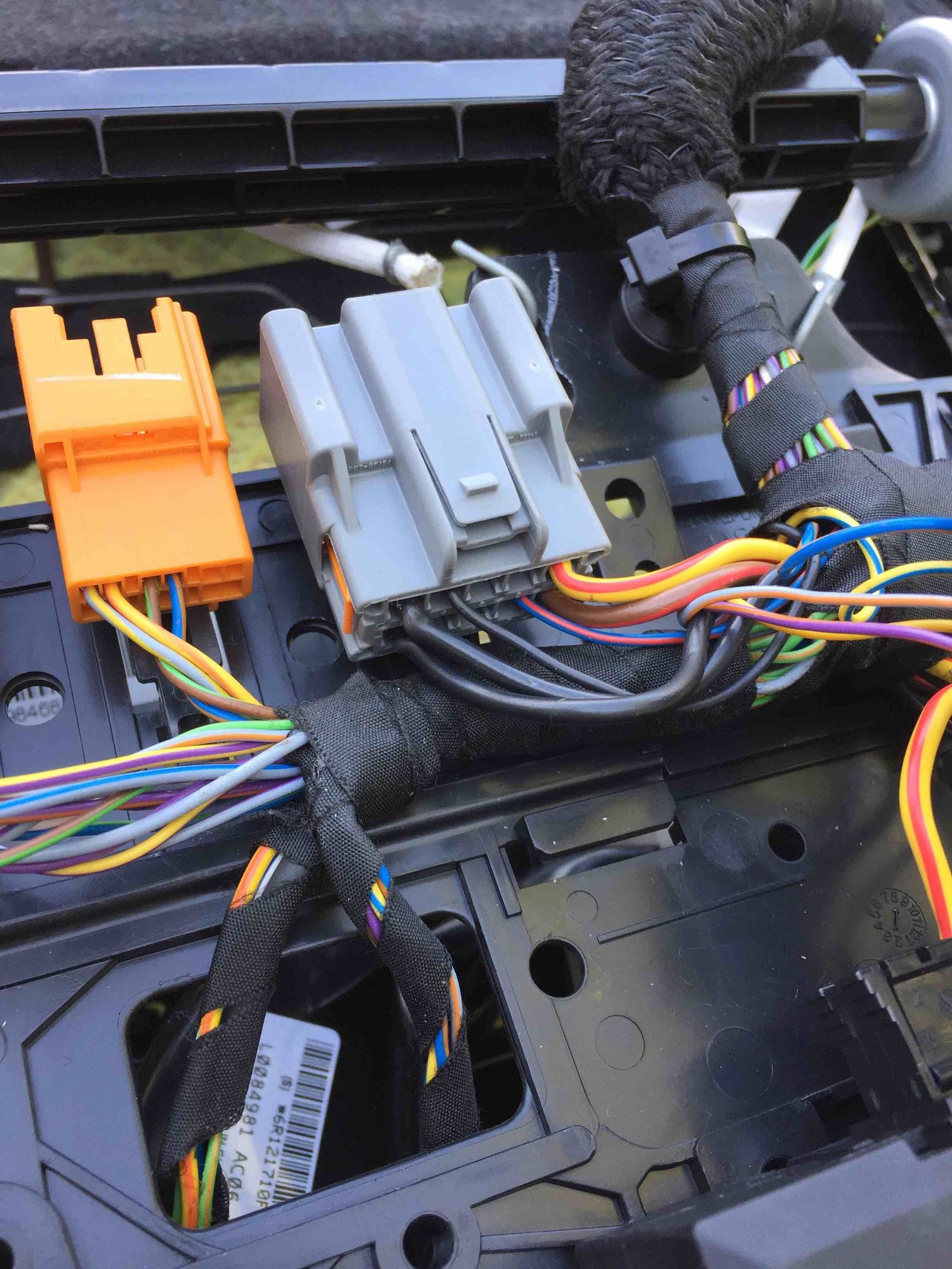

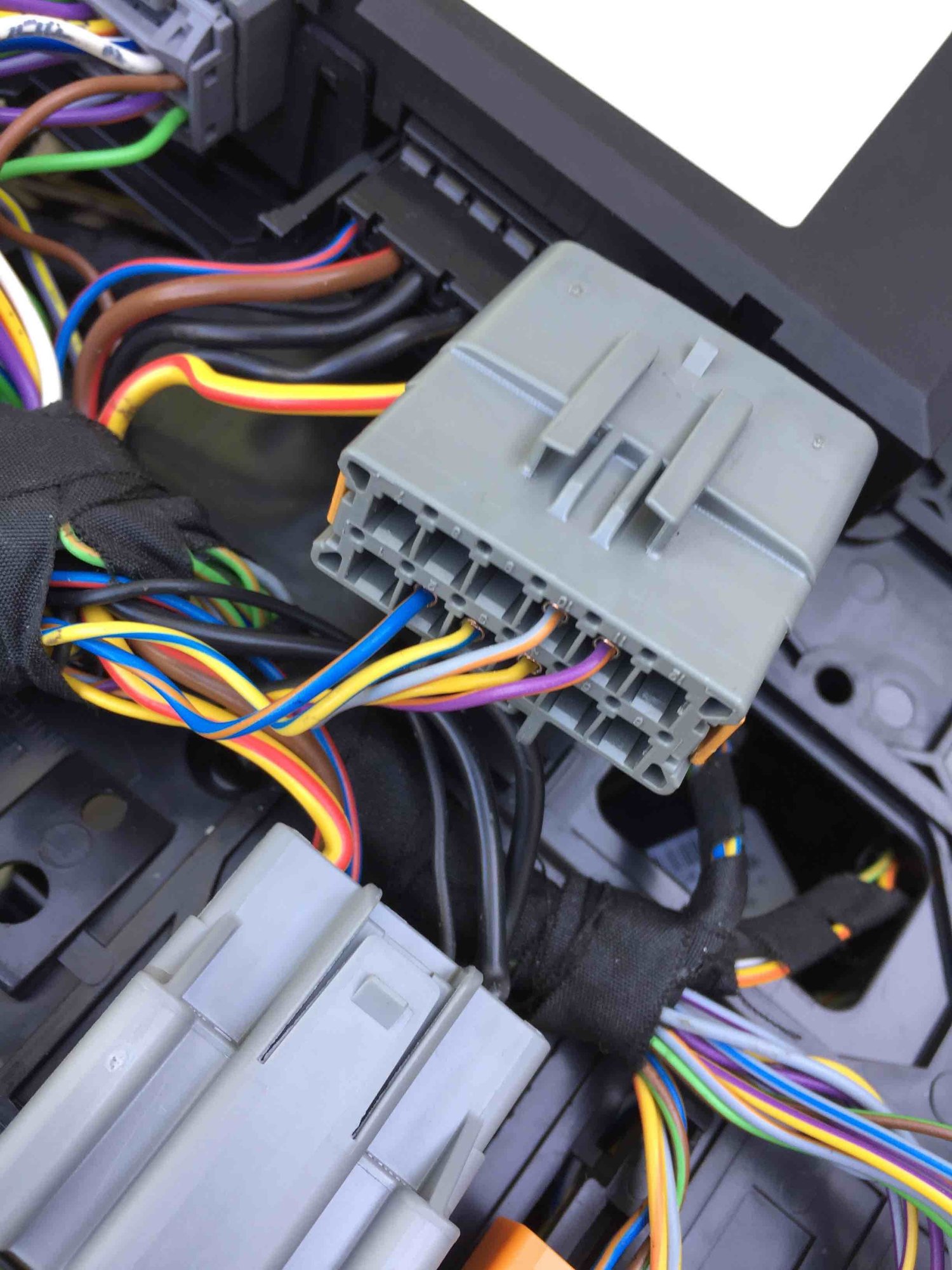

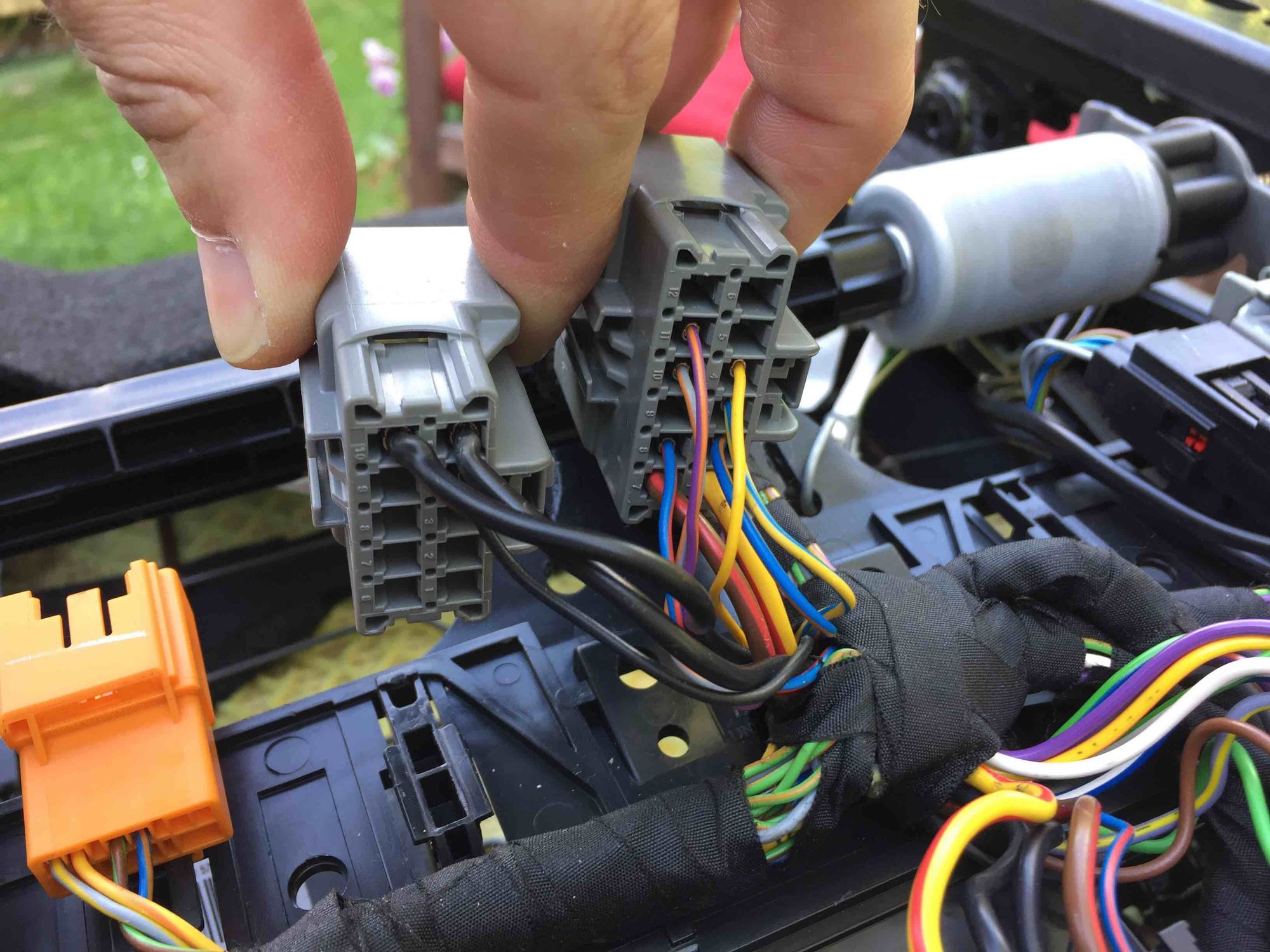

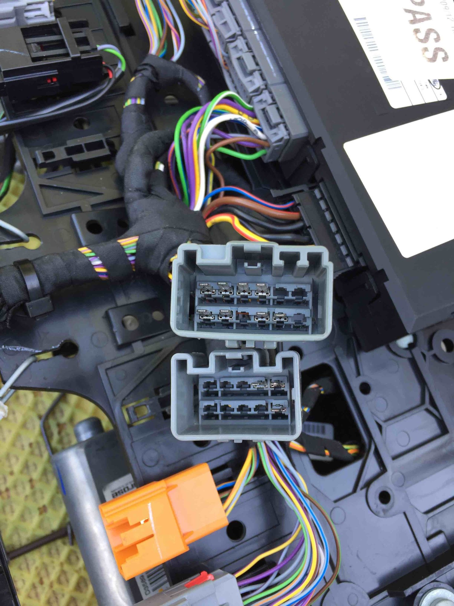

OK, I have spent a bit of time to try and get climate control, module connectors from damaged cars without success and the dealers I contacted would only sell me the entire wiring loom of car for 400 Euro! I don't think so!
I will try to find a solution as you suggested with the SPX repair kit however my knowledge of this is limited. I will do some research.
I will nevertheless go ahead now and connect the new seats as soon as the new harnesses arrive for them. Could you confirm the following plan:
For connector A:
To get all motor and pump function:
Bu/R wire from car --> Y/R wire in seat
Gr/R wire from car --> Br/R wire in seat
W/R wire from car --> Bu/R wire (lumbar and bolster pumps)
There are also 4 thick ground (Black) wires in car connector and only 2 thick and one thinner ground wire in seat connector. Should I just match the positions of the 3? The fourth position in seat connector is purple-orange instead of black. I guess I should leave this.
In addition, I will not connect the purple/Green (VT-GR) wire from car as this is for the heating element power of the old seats, which will not work with the new seats because that will apparently be controlled by the climate control module (when I eventually do this).
Memory function:
I would however also like to fit the memory switch in the door now and I am not sure which additional wires from the 2 additional seat connectors I need to connect to the corresponding car connectors (connectors B and C).
In car connector B there are 4 wires: brown-green, blue-brown, grey-yellow, green-blue and new seat connectors also have 4 but only with 3 the same colour (grey-yellow, brown-green, blue-brown) and one different (yellow-orange instead of green-blue). Also in different positions. Should I match the colours where I can?
Connector C is more complex as there are 9 wires from the car and 14 in the new seat.
Any ideas which ones I need to connect?
Sorry but I am puzzled by this and cannot really understand the wiring diagrams too well as they do not give a clear impression of WHERE the different colours wires should go. Same for climate seat module!
Here is another set of pics of the corresponding car and seat connectors.

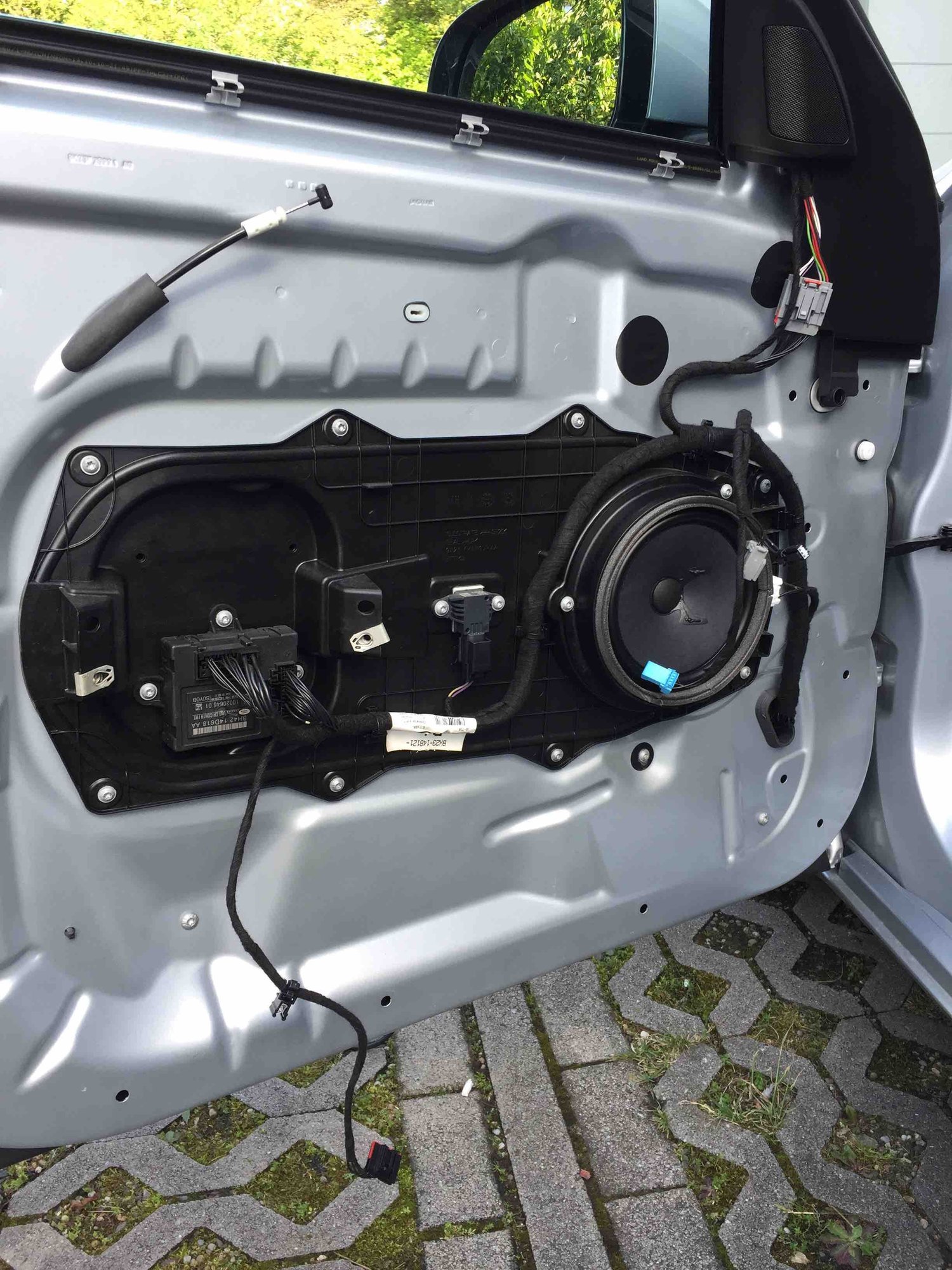

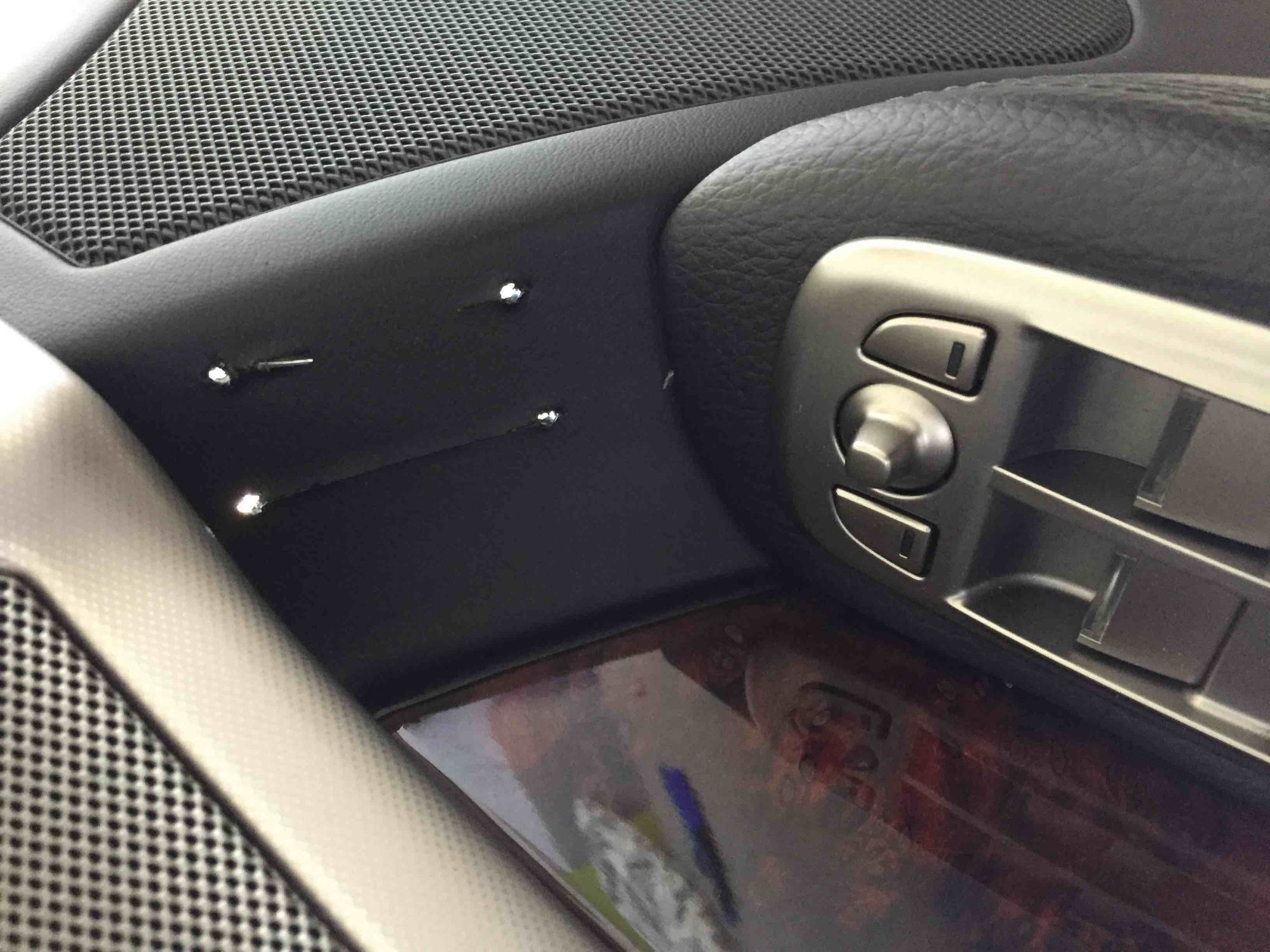

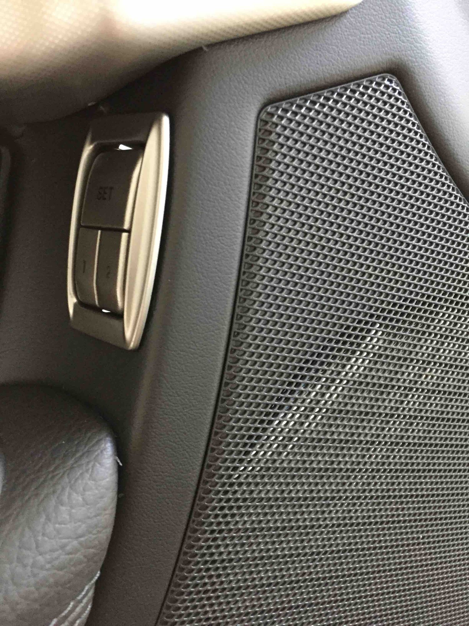

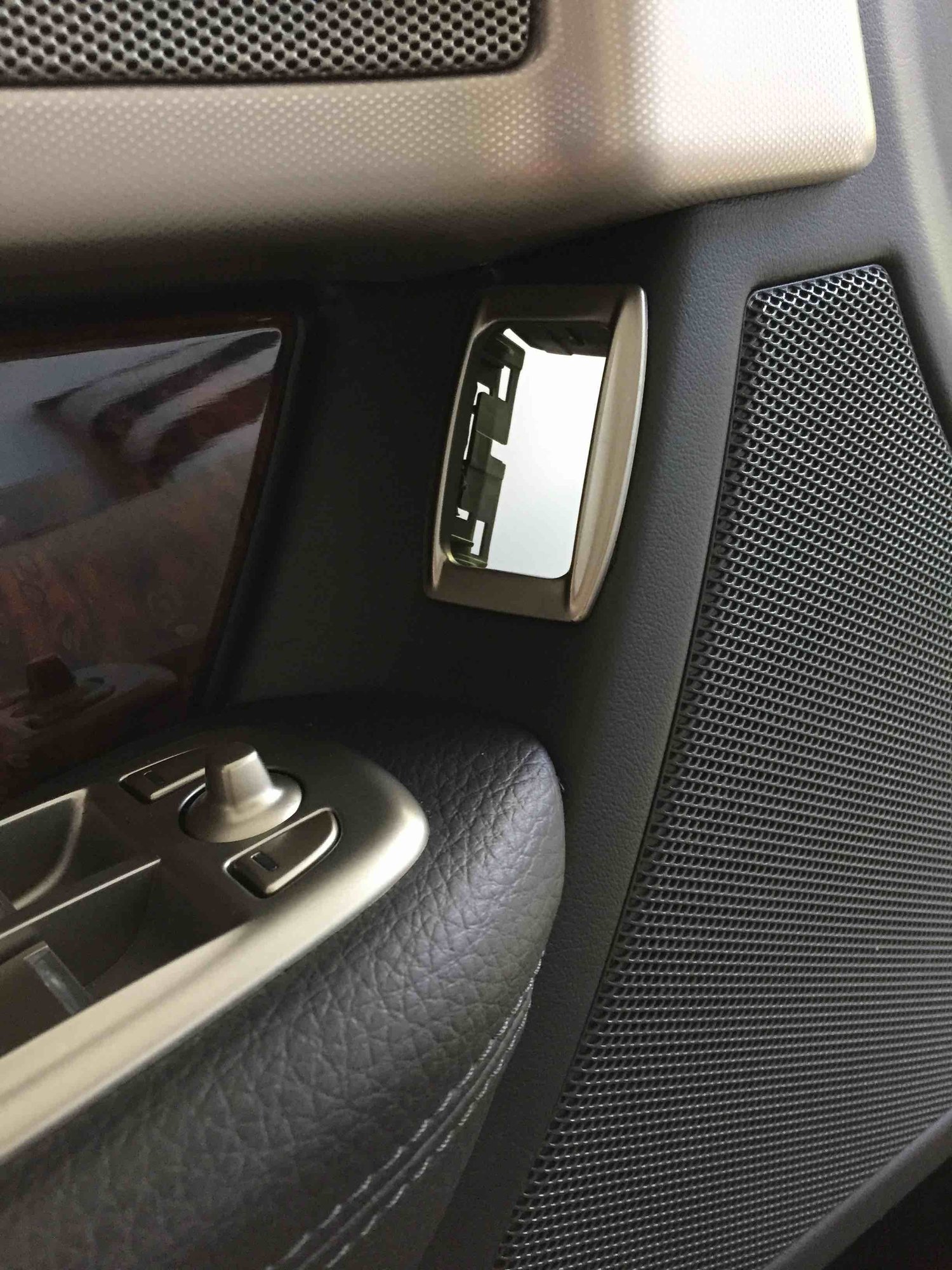

quick update on my seat retrofit project.
As I am still waiting to receive the new connector harnesses for attaching to my new seats, I decided to install the memory switch I bought on eBay into the drivers door.
Considering I did not have the original housing for the switch at the bottom of the door I decided to place it above the mirror switches, which is anyway a more practical position for it to be in my opinion. The length of the wire is just long enough for the existing car connector to reach up there and there is just enough space from the speaker for the back of the switch to fit - as long as you cut the hole near the top of the available space - see pics.
After removing the door panel and connectors https://www.jaguarforums.com/forum/x...es-how-110947/, I cut out a 30 x 46 mm rectangle hole using a drill and my very sharp pocket knife. After a little reshaping to get exact fit I inserted the switch housing so that it clipped into place. I then inserted the switch itself and put the door back on.
Pictures attached in case anyone ever wants to do this. I think it actually looks better than the original position for the memory switch.
drill holes at corners of 30 x 46 mm rectangle and cut out with small, sharp knife. I cut from behind to avoid potentially damaging the plastic.
Inserted the housing of the switch into the hole, after making a few adjustments to the shape.
Inserted the switch into the housing
View of the installed switch from behind the door panel
The wire for connecting to the memory switch (hanging down) is just long enough to reach the position at the top left of the speaker as viewed here.
Install door panel and ready to memorise. Actually will have to wait for my harnesses to arrive before I can install my memory seats and test.
