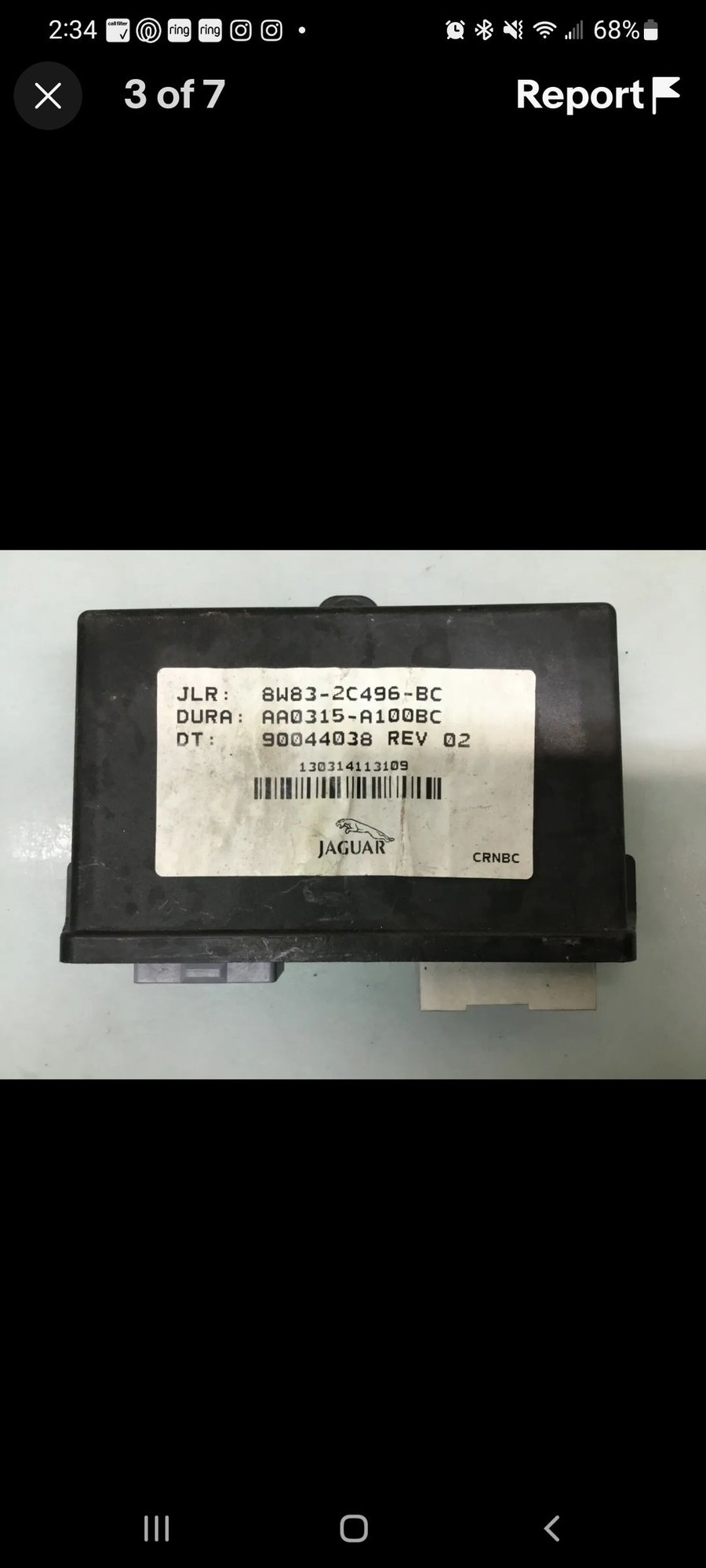

EPB module. On the axle. Probably full of water.
Not that I disagree with getting an SDD scan.
My local guy already has already dropped the rear suspension and checked out that. He can manipulate the motor with the computer.
I even bought one from fleabay and turns out , didn't need it.
The thought of taking it to my dealer which is almost 90 mi from me, is giving me a stroke.
You mean this part? I can find zero information on the location of this part but if anyone knows .... 😬

Don't disagree about the EPB module but that should set some kind of EPB code too?
Hate to replace parts when not sure?
Plus if the module was bad how could his device operate the motor? Looks like the module has to command the EPB motor?
