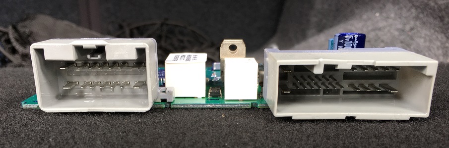

I took out the PB module in the trunk to see what made it tick. You can find it on right hand side of trunk behind the trunk liner.
Then disassembled the module to look at the circuit board trying to see if any component seemed damaged.
I didn't see any obvious issues so I sprayed the connector pins and left the module out of car for about a week or so(I ran out of time that day and forgot about it for awhile
Past weekend I put it all together with the thought of looking at it closer in a warmer weather(it snowed here in Michigan on Saturday). Then everything worked! No issues!
I can't claim I did anything other than freeing stuck parking brake earlier by jumping the connectors with 12V(see my earlier post) and taking out the module and spraying the connector pins with contact cleaner. But I'm happy it's back to normal.
Attached Thumbnails EPB Electronic Park Brake - question-pb-module-trunk.jpg   EPB Electronic Park Brake - question-pb-circuit-board.jpg   EPB Electronic Park Brake - question-pb-connectors.jpg

Glad to hear that you seemingly fixed your EPB issue with a zero-cost effort. Keep us posted on whether it stays fixed....
