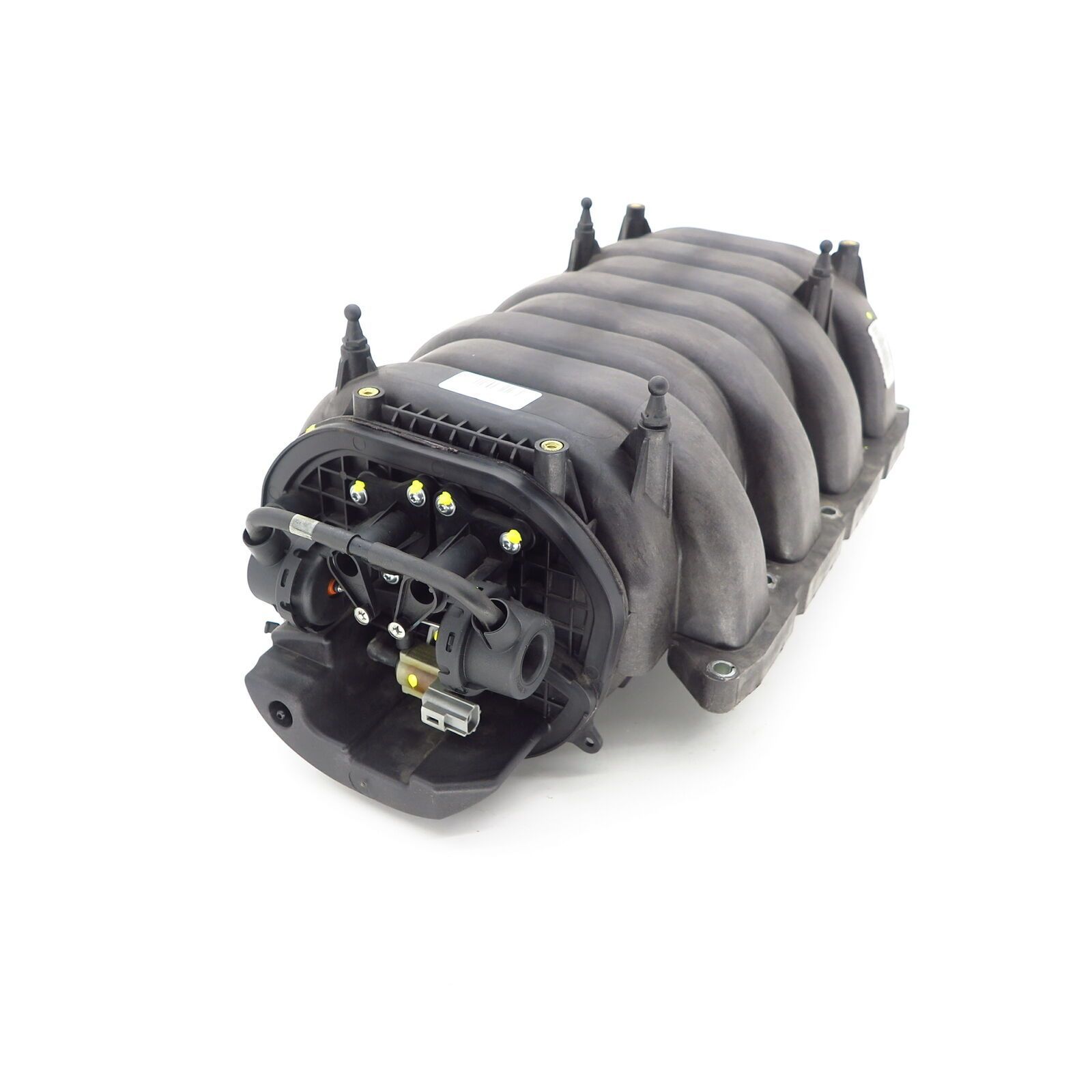

I recently encountered a similar noise on a LR4 (Discovery 4) which uses the same motor. I mistakenly thought it was the timing chain tensioner noise that can happen on these engines so I started doing the replacement job only to find new timing chain components had already been fitted. So I reassembled the motor and carried on with trying to identify the noise. I discovered the noise was the loudest from the top of the engine and only from around 2000 rpm and up so I removed the inlet manifold which is a very easy job on the LR4.
I then removed the variable intake actuators on the rear of the manifold and discovered the problem. Each of the actuators control a shaft that runs from the rear to the front of the manifold internally and the one shaft was broken which allowed it to move around and caused the clattering noise. I did not even try to repair it and fitted a good used manifold which solved the problem. If you are not able to source a replacement it may be possible to open the rear of the manifold to make a temporary repair but the actuator mounting assembly is bonded to the manifold which will be difficult to remove but doable. I dont know what the internals look like but whatever you do, you need to ensure that there is no way for components to come loose which could then be ingested by the engine. That would be terminal.
Perhaps the variable components could be locked in either the closed or open position which would mean the engine would be less efficient and performance will be suffer but it will allow the vehicle to be used until a replacement can be sourced.
So, hopefully you are correct. Ordered up a used replacement, should be arriving next week. The rattle has gotten worse, up to a point where I don't even want to start the car and I believe its coming from the manifold since the sound originates from that area. I was suggested it might be valve lifters or timing chains, but the sound is centered I feel.

So, intake manifold arrived. Replaced it and all sounds that were there and I did not like (there was a strange whine sound when it was idling especially, I think coming from the throttle body) ARE ABSOLUTELY GONE.
The job itself was an easy one, took a few hours with my friend. Just be careful when disconnecting the back of the manifold because there are some parts there that can break easily.
I also think my mileage has improved by like 10 - 15 %, and the throttle response is better. Thank you for the advice, gt40. <3
