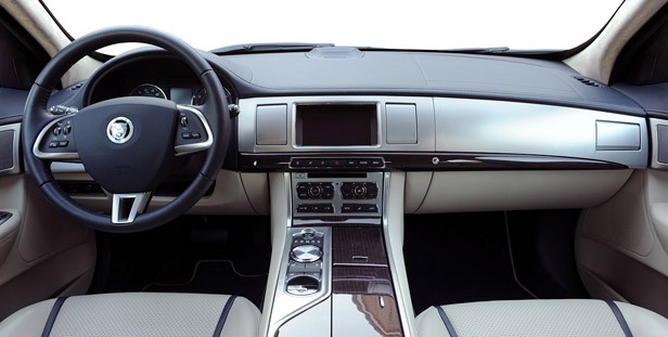

I believe the tell-tale sign on the 2012 is the center channel speaker on the dash, which sticks up like a hump. It also has the Bowers & Wilkins logo on it.
Attached Thumbnails How can I tell if 2012 XF SC has B&W from pix?-lead11-2012-jaguar-xf-supercharged-review.jpg   How can I tell if 2012 XF SC has B&W from pix?-xf-int_031-625x416.jpg

Thanks for the input. That helps. However, as I dig for info it looks like there were actually three different stereos available in 2012, with the 1200W B&W being the top dog. (And I agree that the center speaker hump indicates the big B&W.) However, I'm trying to determine if the mid-level stereo is decent enough. I can probably live without the 1200W beast, but can't deal with a bad one.
