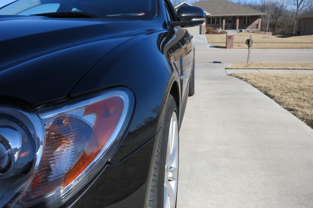

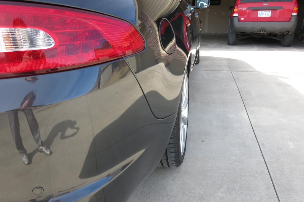

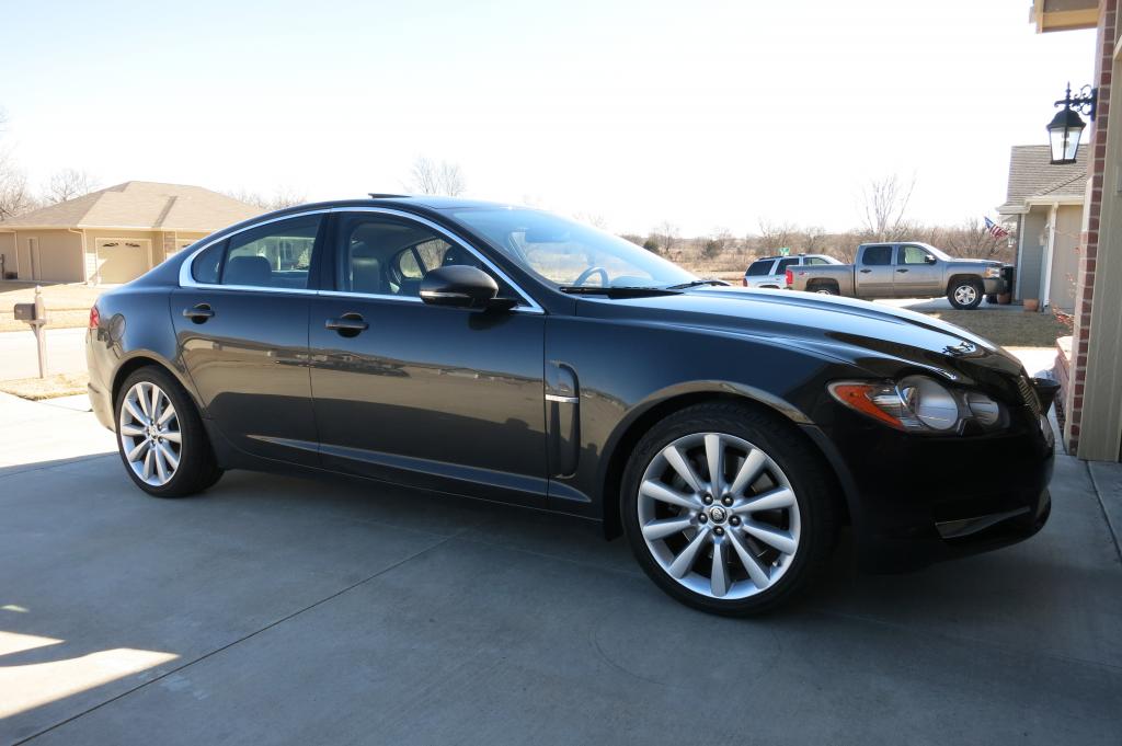

I got around to installing my wheel spacers today so I thought I'd throw up some pictures for anyone interested. After seeing another forum member's car I decided I wanted to do this mod. The spacers are H&R Trak+, 20mm on the back and 15mm in the front.
H&R 4035633 20mm
H&R 3035634 15mm
The fitment was perfect, and I did not have to grind down the stock studs with my stock 19" wheels. The entire job only took about 30 minutes. Once back on the ground the car looks amazing. It really gives it an aggressive stance. The 20mm on the back bring the tire almost completely flush with the fender, and the 15mm in front are just a bit less flush. You could probably get away with 20mm on the front, but I think it looks better a bit staggered. I haven't driven it yet, but I will post driving impressions once I get it out. I'm not expecting it to feel any different, but we'll see.
Next mods (coming soon) are window tint and an OEM spoiler... I'll be sure to post up more pictures once that is done!
Here are the BEFORE pictures. Notice how far inset the wheels are in the fenders.
During the installation, you can see one of the spacers installed here:
And here are the AFTER photos:

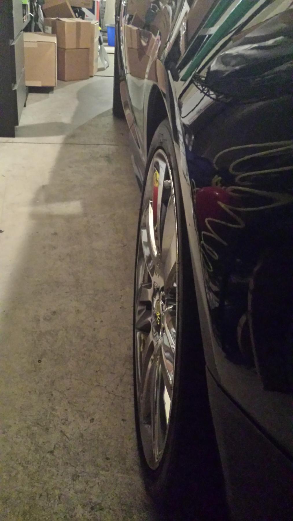

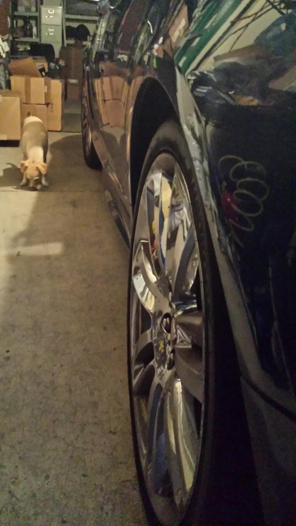

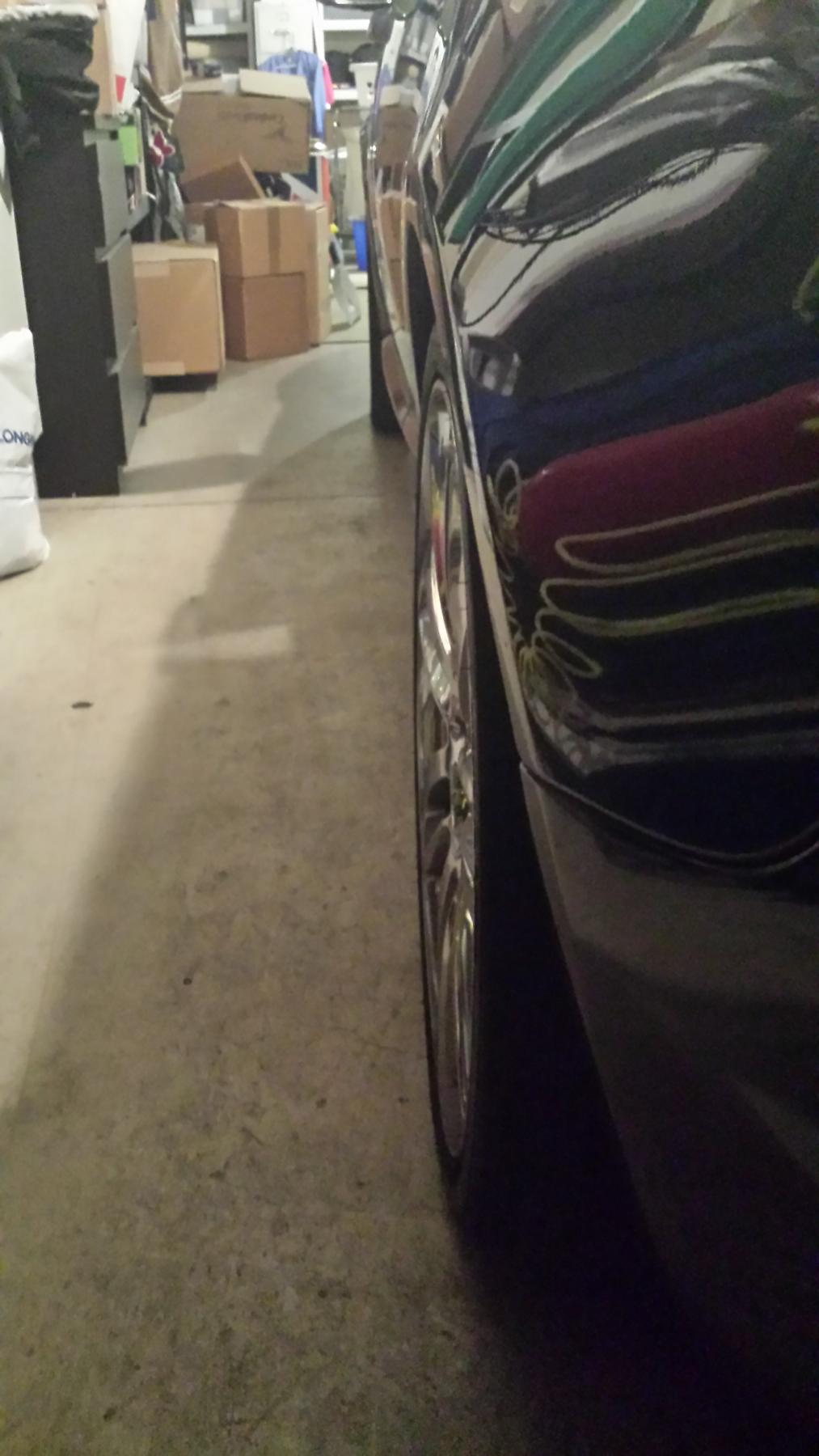

Attached Thumbnails Installed H&R wheel spacers - Pictures inside-20140221_175233.jpg   Installed H&R wheel spacers - Pictures inside-20140221_175314.jpg   Installed H&R wheel spacers - Pictures inside-20140307_221531.jpg   Installed H&R wheel spacers - Pictures inside-20140307_221556.jpg
