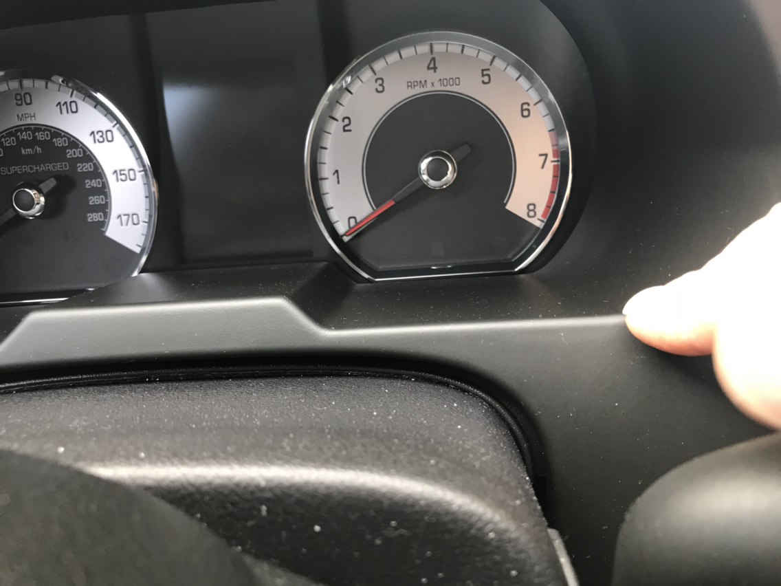

Maybe unrelated, but since having my airbag recall done a few weeks ago, I have an irritating rattle over bumps. It's a hard plastic noise and I've traced it to the black plastic surround around the instrument cluster (see photos). The right hand edge is moving and rattling and in fact the whole black unit seems to move around. It touches the clear plastic in front of the instrument cluster and I think that's the noise I hear.
I can prob just use foam to stop it moving, but does anyone know how it's held on? A screw or clip or something? If not a major job I'd like to refit it properly

The instrument cluster surround is held in place by screws at the bottom either side under the other trim. There is also at least one screw in the top under a small square cover

The instrument cluster surround is held in place by screws at the bottom either side which are under the other trim panels. There is also at least one screw in the underside of top in front of the instrument window under a small square cover plate.
Can the vehicle be returned to the place where you had the airbag replaced so that they can rectify the faulty workmanship ?

The instrument panel surround is held in by 3 screws. One in the top middle above the steering wheel accessed by a small plastic cover. And one of each side at the bottom accessed by removing trim from the dash.

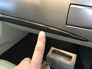

For the right hand screw (on a LHD car) - pull the long trim piece (mine is wood veneer) see photo. Use a plastic tool to get underneath and lever it forward - there are six clips that pull straight out. Easiest to start at glove box end. Simple plug to disconnect the switches and put it out of the way

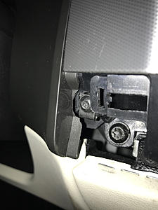

The surround is held by a torx screw into the dash. This is where mine is rattling - easy to replicate. Reason - the plastic tab that gets screwed down was broken off the instrument cluster. And in fact wasn't even there so it didn't break off behind the screw - it must have been broken in the past and someone threw away the broken piece. See photo
On left hand side simply unclip the silver surround to the AC vent. Again just held in with clips - pull straight forwards using a plastic tool to get into the gap. That reveals a torx to hold the left of the instrument cluster. Also broken off and missing... see photo
So for now I got some foam and placed it behind the edge of the cluster where it rattles. And did the same on the other side just in case. Pushed back on the two trim pieces and all done.
Rattle is cured and only 10 minutes of work
I did look up replacement cluster surround - about $60. So I might replace if rattle comes back. But hopefully all fixed!
