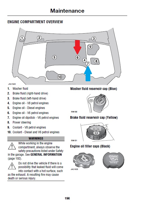

With the vehicle on level ground and the engine either cold or having been stopped for a minimum of 10 minutes to allow the oil to drain back into the oil sump:
Locate Engine Oil Filler Cap (item 6) and Engine Oil Dipstick (item 7) on the passenger side (UK) of the vehicle:
