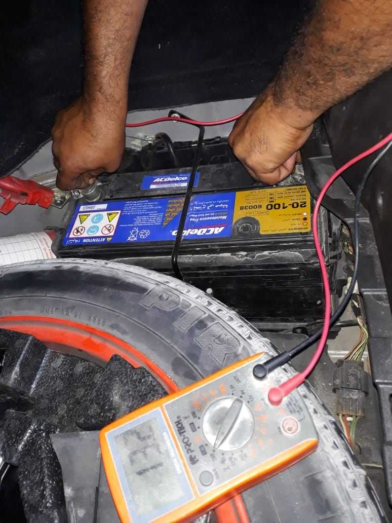

Old Jul 11, 2019 | 10:51 AM
Hanishakir's Avatar
Joined: Jul 2019
Posts: 11
From: Dubai
Kindly find the attached battery test result... please do advise if this is good... Thank you.
Old Jul 11, 2019 | 06:42 PM
OzXFR's Avatar
Posts: 9,030
Likes: 3,664
Yep, that battery looks good, and it is not the original.
Next step is to check all the battery connections, then if/when they are good hook up a battery tender and let it run overnight.
One tip - double check the main clamps on the battery posts, sometimes a non-OEM replacement battery (like you have) has slightly thinner battery posts than the OEM battery and the clamps don't grab as tightly as they should.
