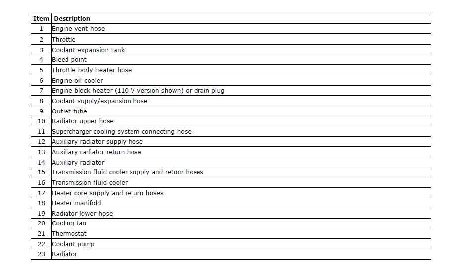

Are you looking for this kind of diagram from the Workshop Manual .....
(click on the images to enlarge them)
..... or ones from the Parts Catalogue illustrating and naming each hose?

YES!!! Perfect. Thank you
Anyone care to take a guess at a likely place to start?
