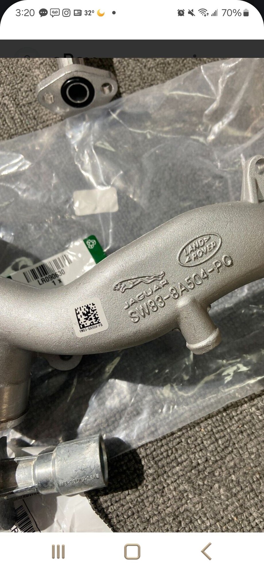

Does anyone actually know the PN? I have the Euroamp parts on my XJ, but I wouldnt mind paying a little extra for the Jaguar casting.
It appears all 24-25 F pace SVR and LR Defender V8s have these from the factory.

Thanks Dennis, curious what you find. I probably should try calling the dealer but I don't have a VIN handy. I'm told 2024-2025 F Pace SVR and V8 Defenders have the metal pipes.
I grabbed these from a range rover forum, not sure if these are legitimate parts or not.
LR186859 upper crossover
LR186917 y pipe

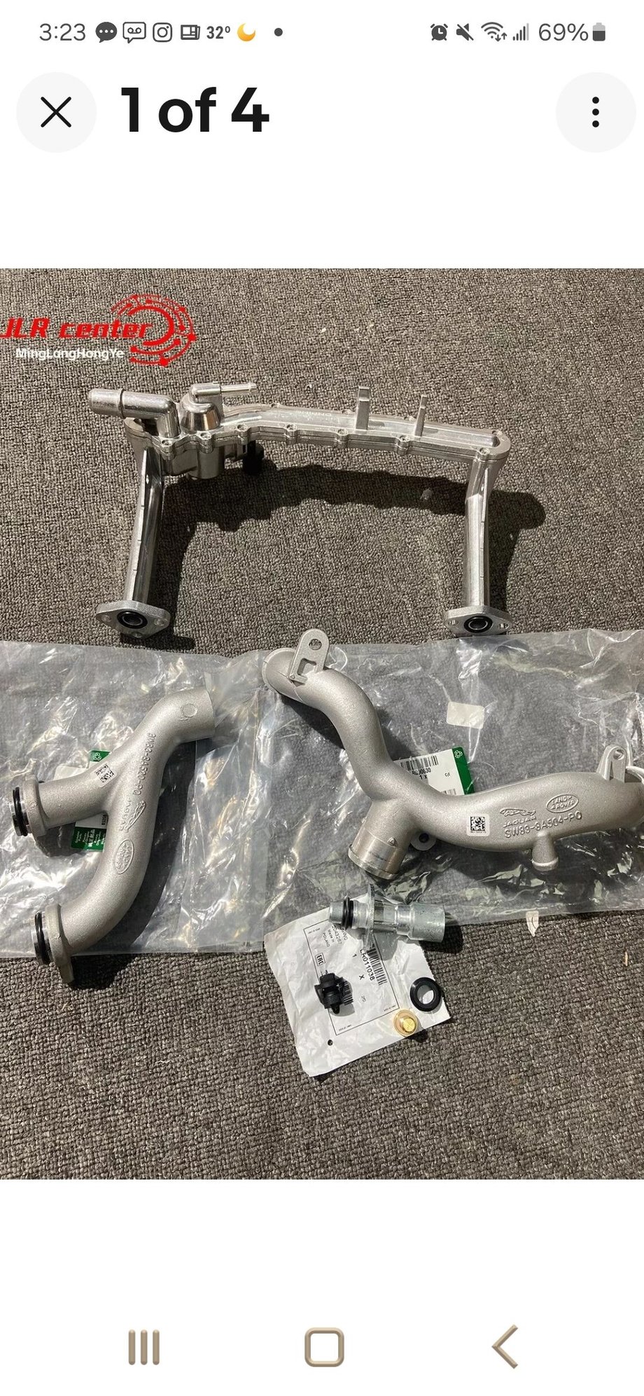

Should these new LR aluminum pipes fit F-type V6?

Yes it will fit Aj126 and Aj133

I just fitted the part numbers that are in this thread to my 2015 XF S/C 3.0, after trying a couple of aftermarket copies.
The after market quality control was very poor, which allowed them to leak. It would leak at the joint where the two tubes met, even using the Jaguar o-rings.

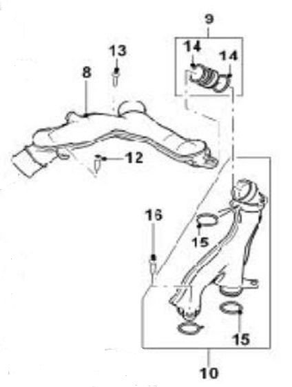

The original Al. pipes were different than these and do not interchange plus there was coupler between the two Al. front pipes that was eliminated when the pipes were redesigned in plastic. The original Aluminum pipes were fine BUT the coupler O-rings could fail and cause a leak.
Here is thread with more info and some pictures. Do note davetibbs comment in that thread.
Coolant Pipes
The original versions are easy to tell because of the "crooked" neck that the redesigned pipes do not have.
The coupler that was between the two pipes is now gone it was item #9.
Coolant Pipes
Do you have a picture of a one piece front pipe, cause I have never seen one? Aluminium or plastic.

The new EuroAmp and aftermarket solution is 1 piece as well as the alleged Land Rover Defender V8 / SVR pipes in aluminum. I asked my dealer to confirm the accuracy of PNs because my F Pace SVR did not come with a front crossover made with aluminum. It looks like glass filled resin which should last much longer than the original design.
