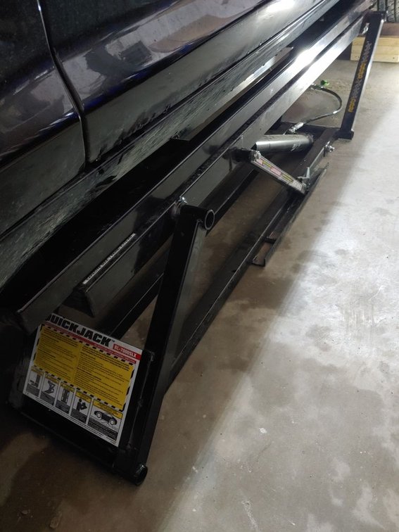

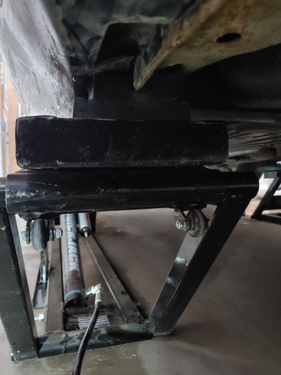

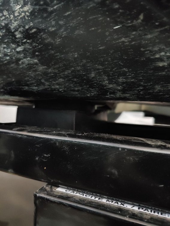

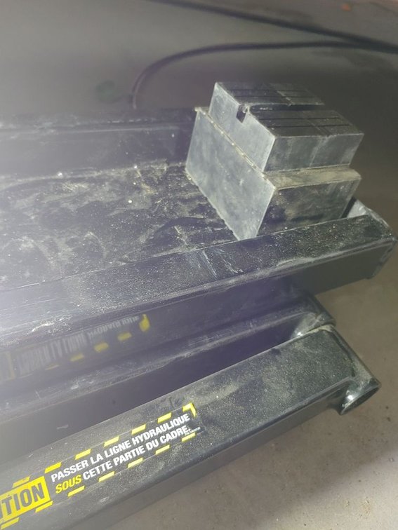

OK, as promised, I have uploaded how I have to use the QuickJack 7000 SLX.
1. I made the wheel blocks to place under the tires/tyres and used a floor jack so I can get the height for the QuickJack. (My garage has a bit of a slope so I have the chokes for safety)
2. I roughly aligned the QuickJacks beside the car and placed the extension pieces on.
3. Using the smaller of the two rubber block sizes that came with my QuickJack, I placed them in the extension locations, placed the round pucks at the front to fit the jack location and I purchased square blocks with slits for the rear. (as the rear is not sitting into the slot on the car but before, I made sure it was wide enough to support on the inside rail without damaging the skirting. I also want to ensure proper support for the front weight.
Always verify that the lift is locked into the safety position when you drop it into the locking position. I have has a few times one side would lock and the other side would release when lowering.
Also, sorry about the messy car but today it was snowing and slushy so once the work is done, she is going for a wash. She is one of the daily commuters but it doesn't mean she is not special.
Kevin
