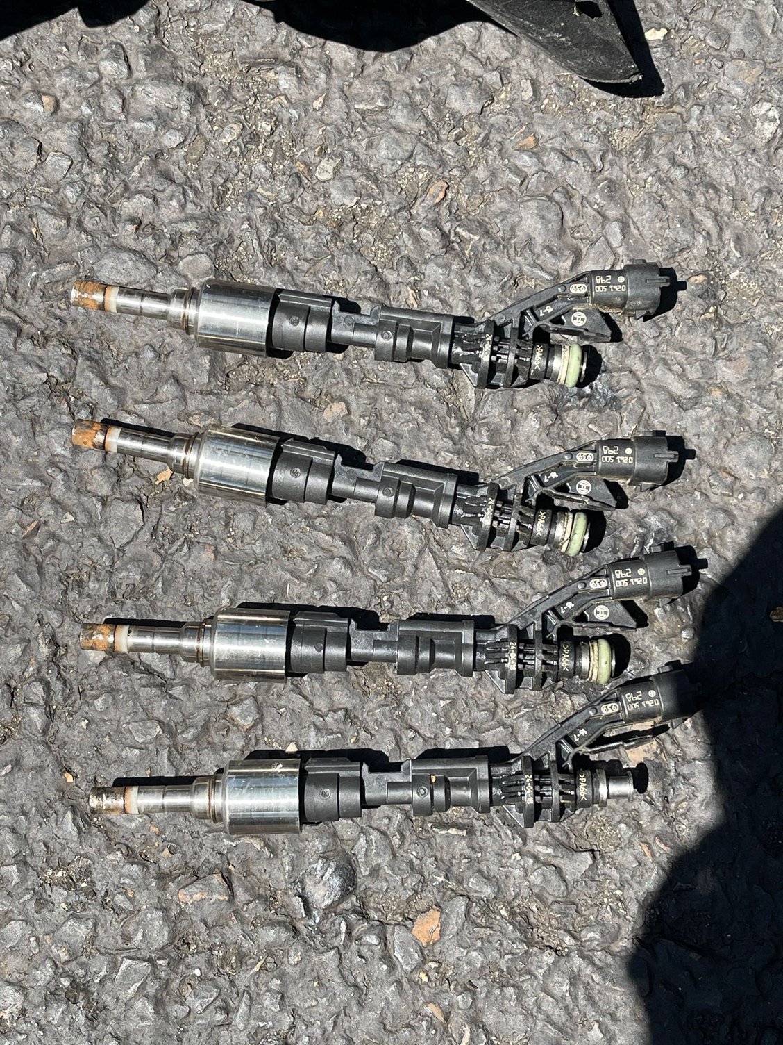

I'm assuming when you ask if the chain broke stand time, you mean, were all the marks lined up? Currently I have not re-verified it. I did however, have to go back into the engine after I installed the chains to get the tensioners to "click" to the correct tension. I double checked timing then and everything was good.
I pulled the injectors today and discovered what I believe may be the culprit. Which is good, because I was getting ready to pull the valve covers to check the timing. What did I find? Easy, injector #8, even though I thought I had verified it...was a counterfeit injector. Which would explain why my misses were always on the left bank...and why it appears the left bank reads "richer" than the right bank as it appears the left bank long term fuel trim hovers around -12, vs the right side at -6. (give or take) Here's a pic of the left bank injectors (#2 is the top injector in the picture):
I'm going to put the car back together with the injectors and coils from my SC project engine and see what happens. Fingers crossed everything clears up, and I'll know it was the crap injector. If it doesn't, then it's time to pull the valve covers and triple check the timing!

Sooooo.....swapped out the injectors and still have the same problem. Valve covers are now off, and as soon as it's cool enough to start working again, I'll get the engine timed up and we'll see where we stand!
