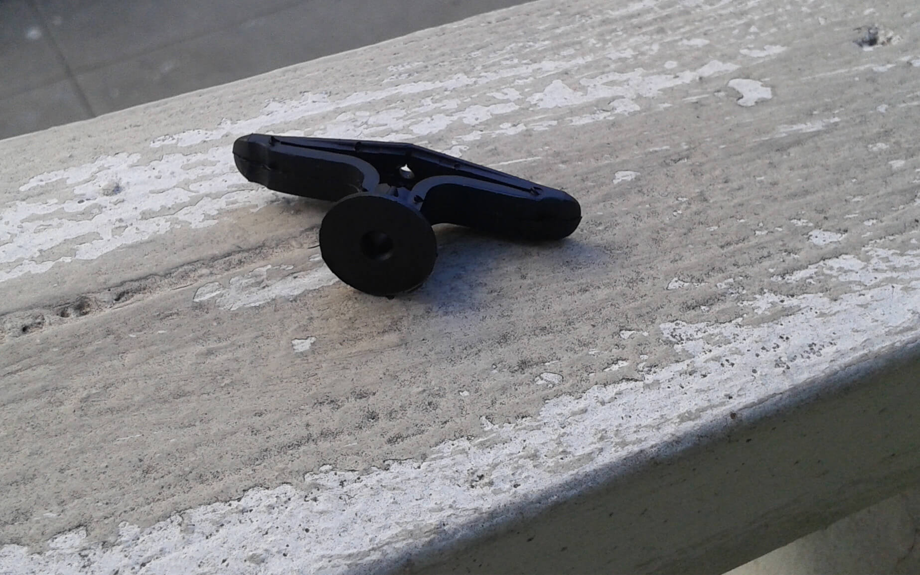

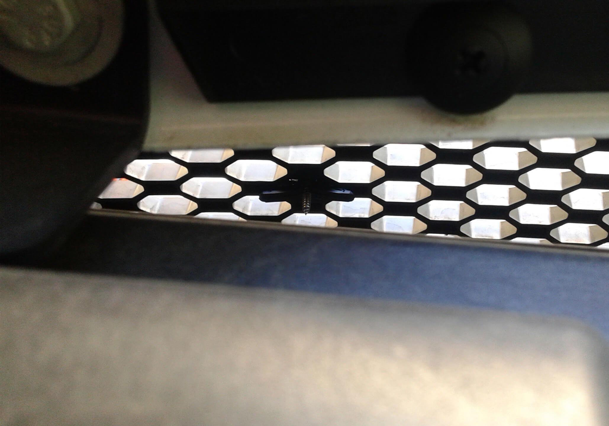

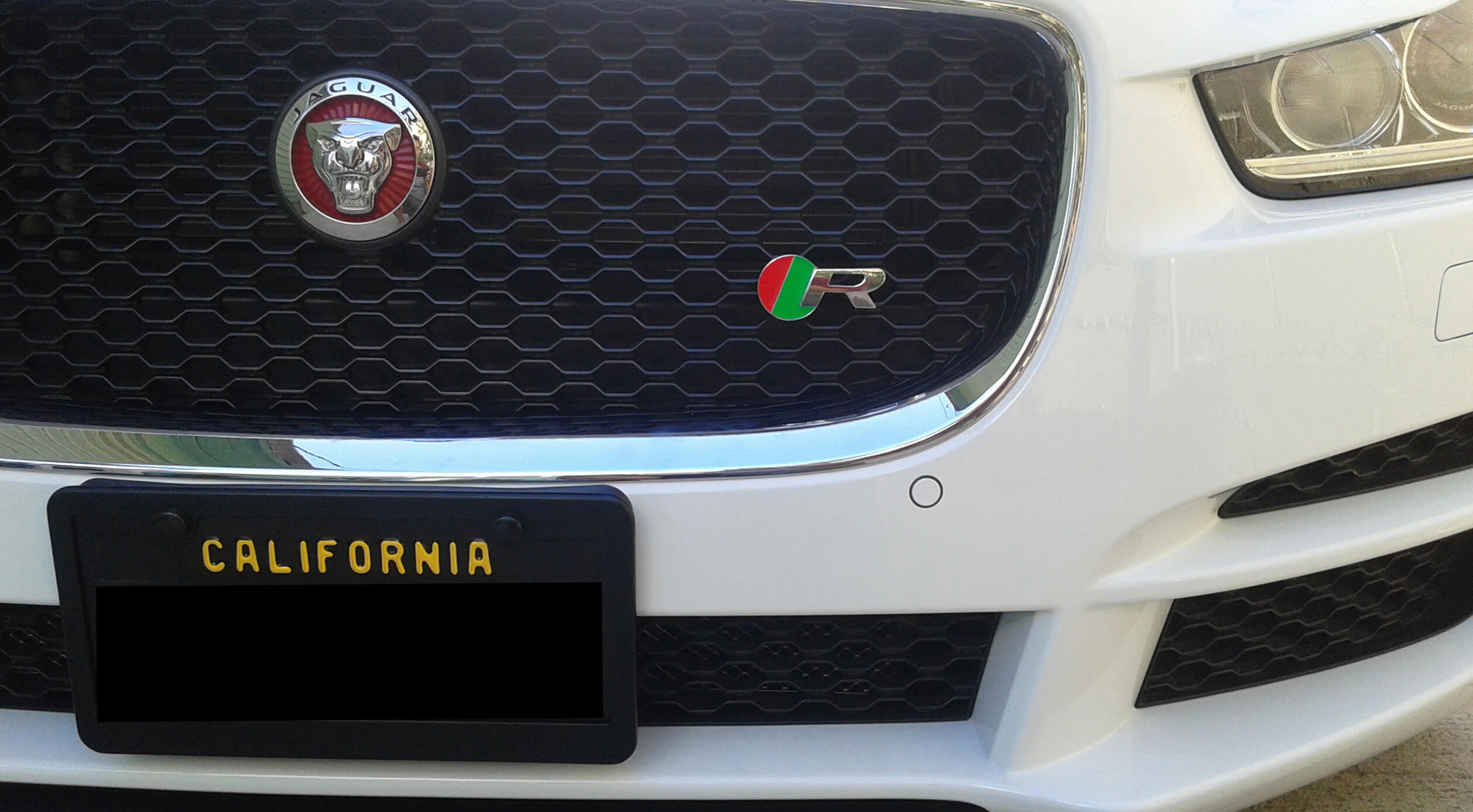

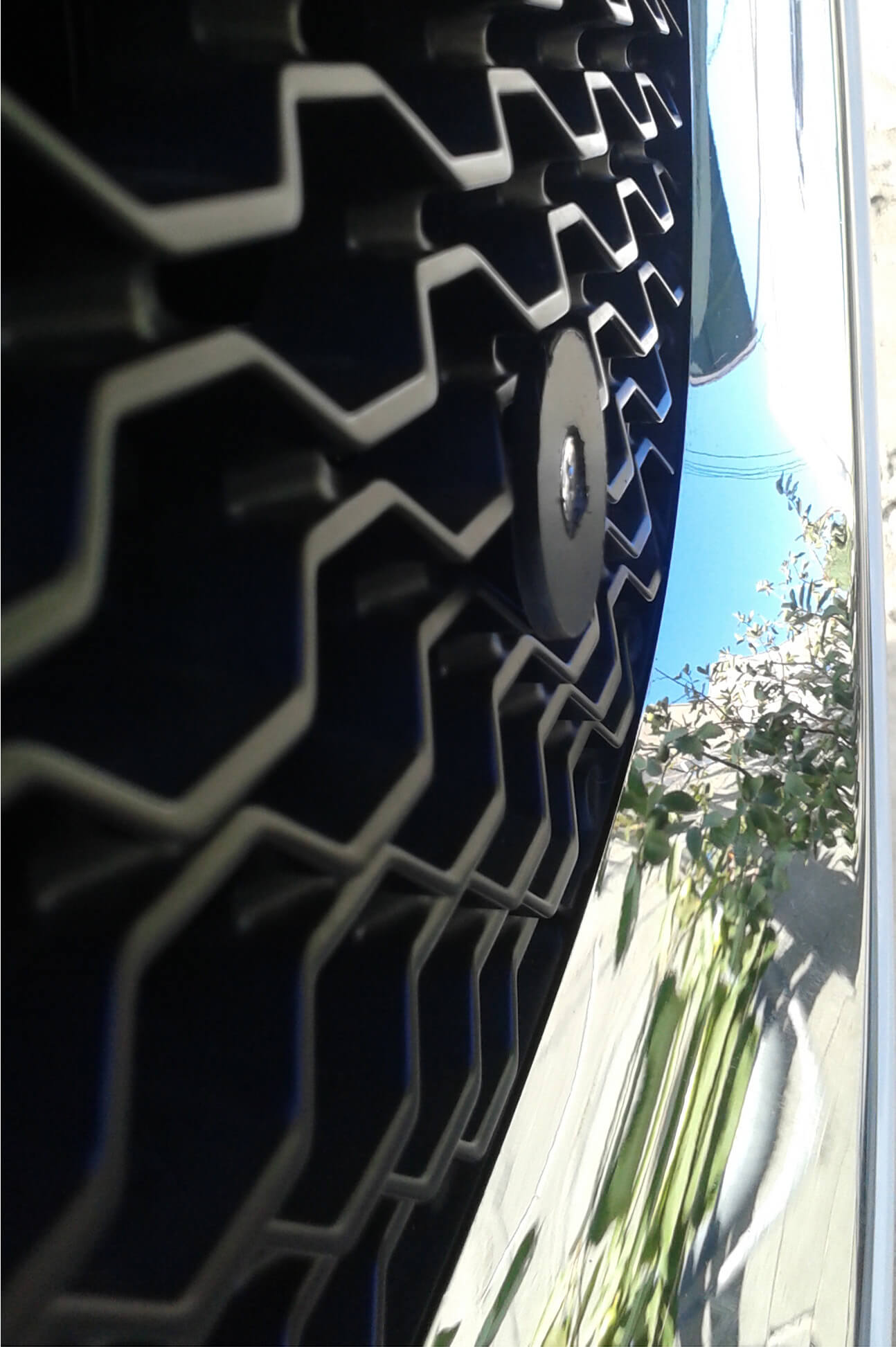

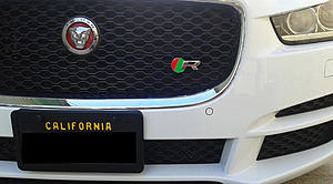

@ttboonie thanks for the steps to use the toggle anchor to attach the badge onto the grille. Followed his steps to get it done but I had to slightly do it differently with some improvisation in my case.
Tools that I used:
-Black & Decker power drill. Nothing fancy, just something with adequate rpm to drill a hole through the lexan sheet.
-Hole saw 1-1/8 in. Use to cut a hole through the lexan for an almost perfect circle to attach the badge onto and mount on the grille.
-Lexan sheet. Home Depot didn't have anything smaller than 0.093 in. thickness, so had to get this one. It's not terribly thick, I feel it's just about right.
-Pop toggle 3/8 in. The 1/8 felt too small and short. The 3/8 is just about right.
-Countersink drill bits. Used the 1/8 bit to make the hole for the flat-head screw so that it sits flush into the lexan.
-#8 1-1/4 in. flat-head wood screw. Flat-head works best because you'll want the screw to sit flush into the lexan.
-3M extreme hold double-sided tape. The one that comes with the badge is not sticky enough.
-Rapidfuse adhesive. Use this for extra hold from badge to lexan. I guess this is optional but I just wanted to be safe.
-3M sand paper 1500 grit. Optional, I used this to smooth out the edges of the cut lexan circle piece.
-Quick Color flat black. Optional, I used it on the lexan cut circle piece and pop toggle anchor. Wanted it to match the grille.
The part that took me the longest was making the countersunk screw hole on the lexan so that the screw would sit flush into it. Took a little work and improvisation and using multiple countersink bits to make the top part of the screw hole large enough that the flat-head screw sat flushed into it.
When you fold the toggle anchor and insert it through one of the holes in the grille, while tightening the screw with the lexan onto the toggle anchor, you can use your fingers to hold onto the back of the toggle anchor legs through the grille. At least that's what I did to hold the toggle anchor in place while I tighten the screw.
So far the hold is very firm and tight. Haven't had any issues with it becoming loose. I guess the only way it can come off is if someone decided to grab and pull on it hard.
