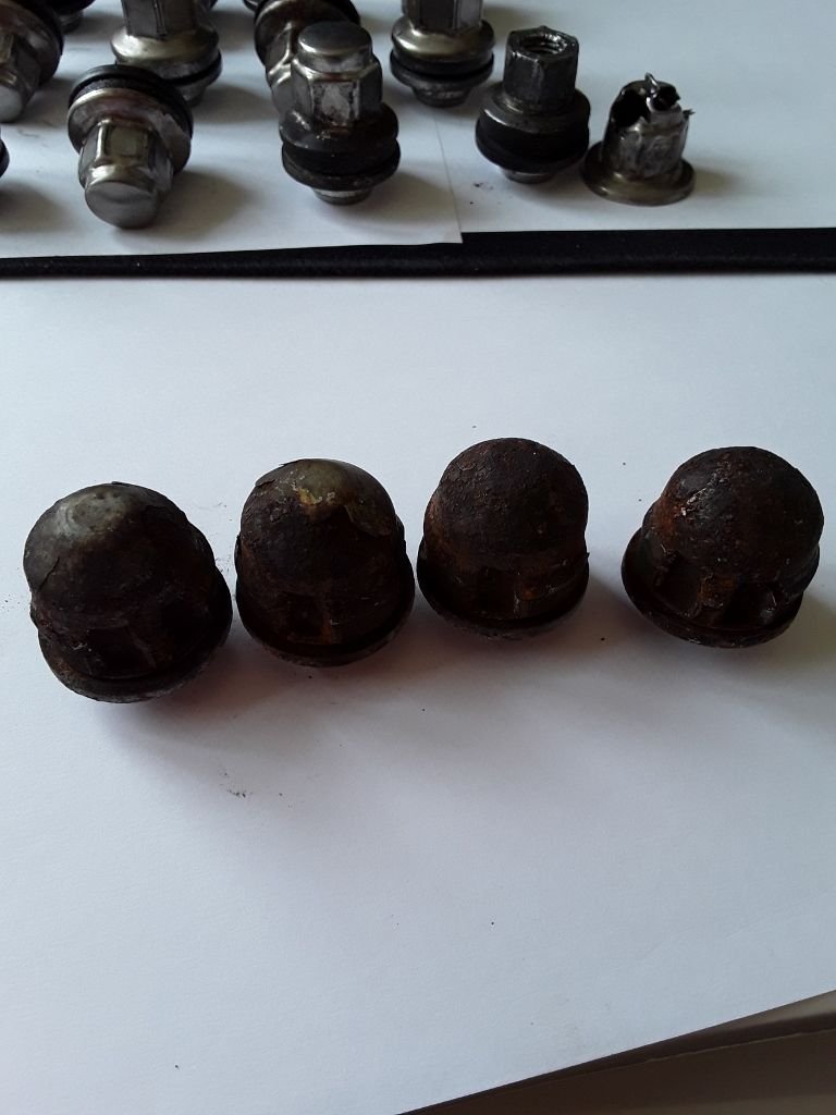

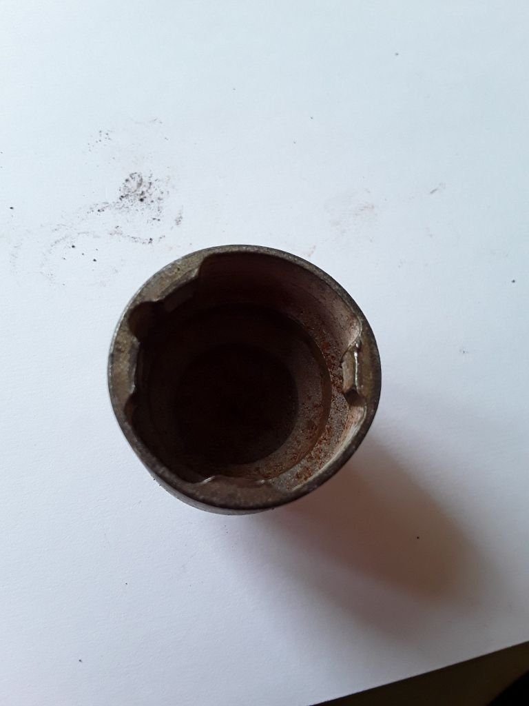

Regarding my post about wheel nuts.... I have done it... changed locking nuts first, they were very very rusted see photo...... 19 nuts came off fairly easily but the one i left till last...well not so....previously person rounded the chrome cove so 19mm would not do anything....managed to remove that cover again fairly easily, then used an 18mm socket and to my relief it came off..... now have 4 wheels I know if need to will come off.. see photos...if anybody wans 19 used nuts ans 4 very rusty used locking nuts with locking nut remover let me know.
