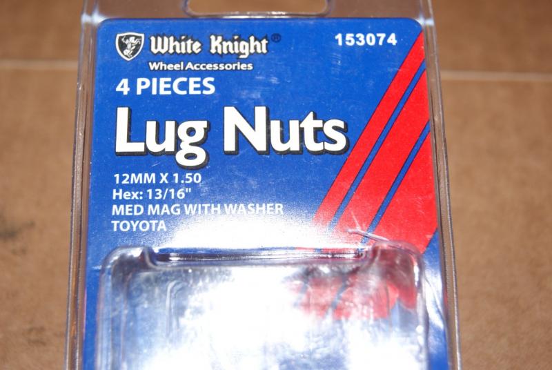

Default Solid Lugnuts
I purchased these at PEPBOYS
