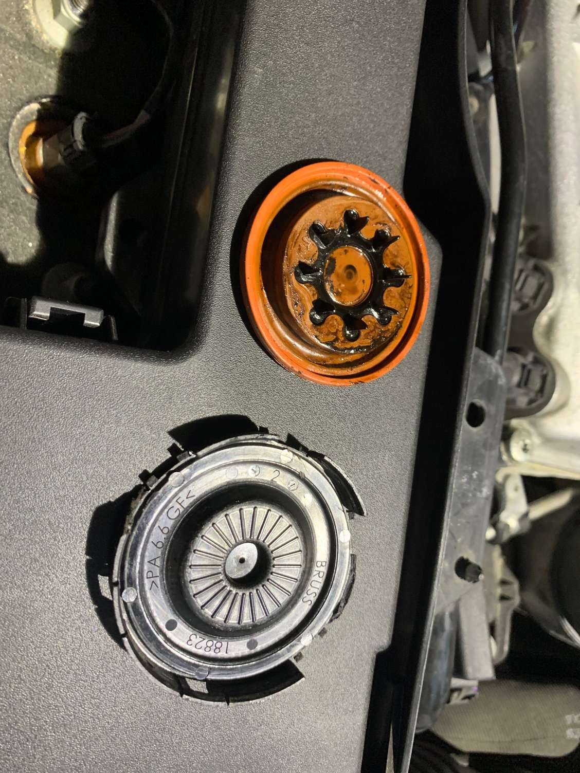

Ok got the caps off and the car back together.
I did unplug the coolant lines, Ecu cables and pcv to throttle body tube. That left enough room to get everything done.
I did have to cut the tabs on the new caps and spin them into place and I didn’t have to remove or loosen the supercharger.
Old cap
Bad valve
New cap modified by cutting 2 tabs off
Cap spun / threaded into place with our removing supercharger
