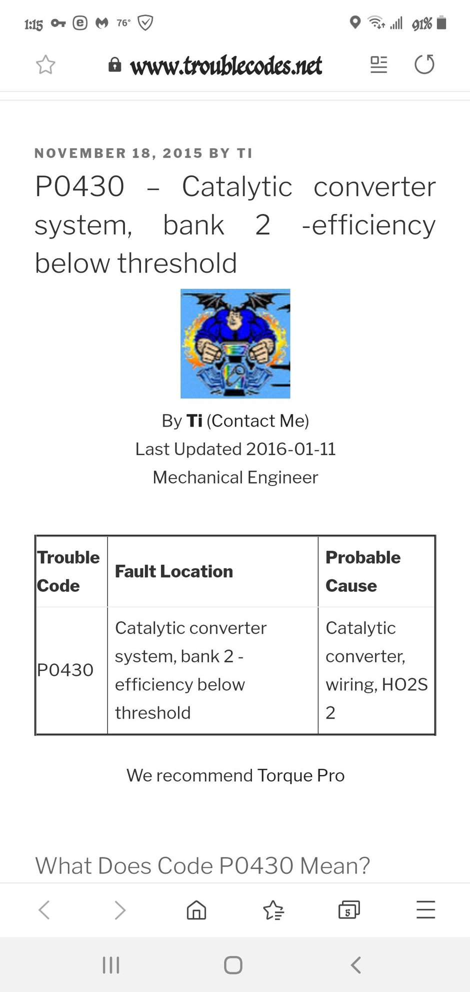

so got this but reading around here and other places just really doesnt seem to give a straight answer
got it off torque pro but i didnt build a car profile
i know you guys are pretty good on these things, any thoughts/ideas?

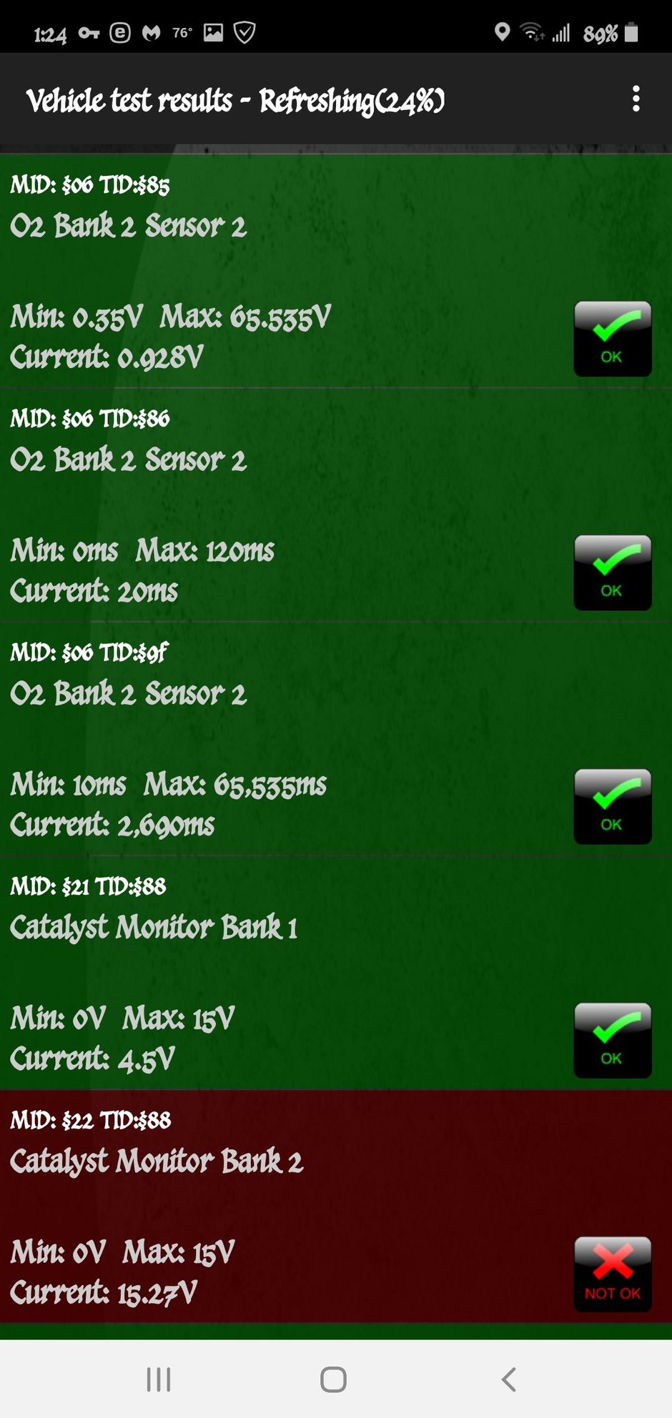

here some screen shots from toque pro
and if you do replace the o2s is it better to just replace all of them of just the messed up one..
and i have no idea abiut what sides bamk 1 or 2 etc is 🤷🏻‍♂️🤦🏻‍♂️

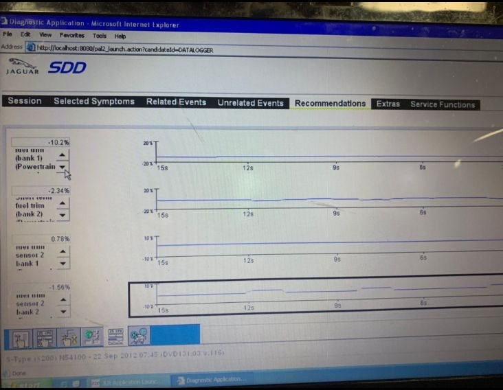

my car ran fine with the exhaust leak and p0420 code. I wouldnt have noticed anything wrong bc it drove well. But the MIL light was illuminated so I checked the codes.
you can see a vacuum or exhaust leak by looking at the short and ling term fuel trims. Mine where jacked up. I also had a small intake leak where my air cleaner tube was a little loose on the aluminum intake.

I checked the codes myself with Sdd software I bought online. Cost $100 and was worth it!
