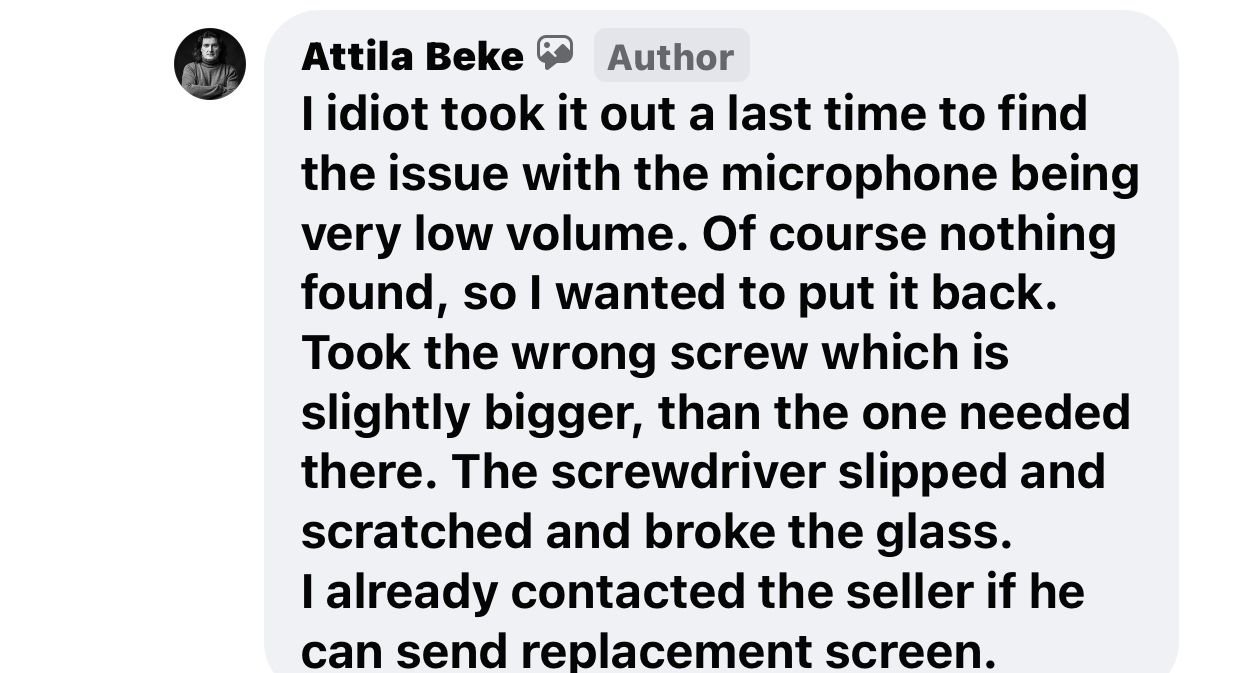

I got the replacement screen, but I didn't install it yet, because it's so cold out there and I am not that fancy to go out and start taking off the dashboard.
I will do it as soon as the weather gets better. Hopefully this weekend.
