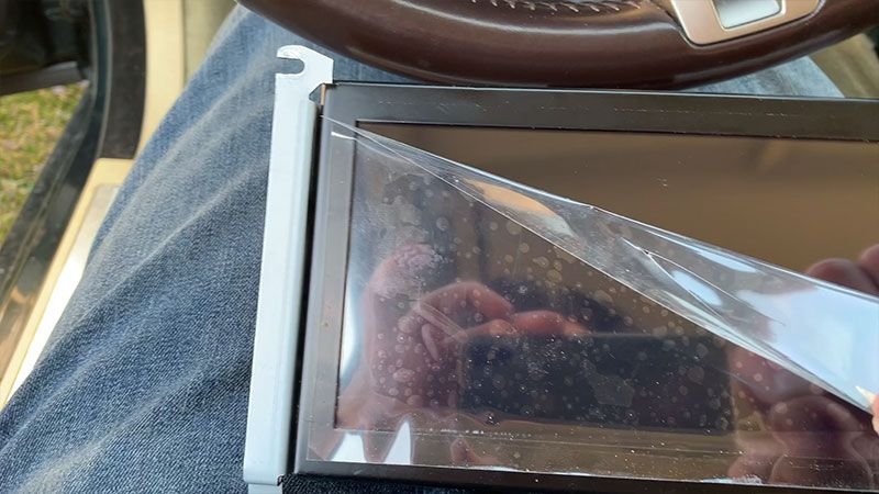

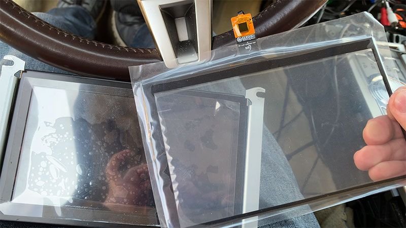

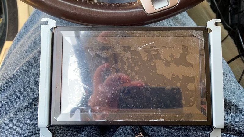

You won't believe what happened.
It turned out that I didn't scratch the screen, but a foil, which was on the screen all the time, but I didn't see it, because it was under the frame of the screen.
When I tried to replace the screen and removed the frame, I realized that there is a foil.
I removed the foil and the screen had only a small little dot as damage. I decided to keep the original screen, because the touchscreen is somehow glued to the display plate and I didn't want to use force trying to remove it.
I was scared that I really break the original screen and can not get it off the plate after all.

That's hilarious 😆, but I'm very happy for you, in case something goes wrong you have a spare screen now.
