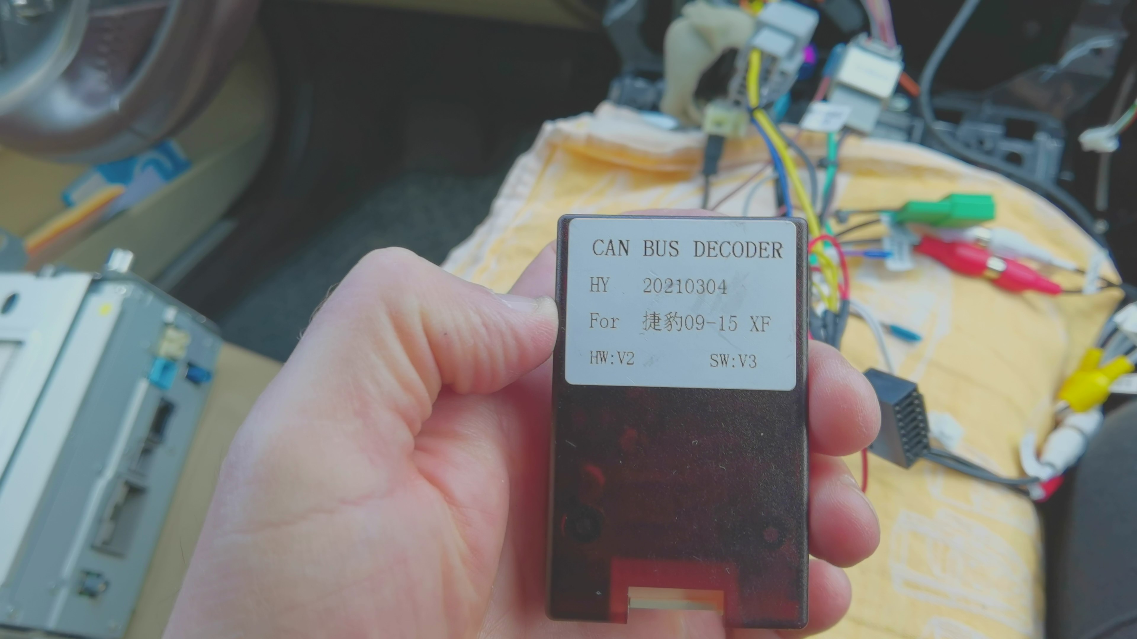

So after installing the unit in my MY2012 XF, there's been a few problems which I've stated in the Telsa Screen forum, although mine is a 7" and they are:
1. Even though I had one with a new type of bracket it didn't fit. The Top was to far forward and the bottom a bit to far back. So I took out the top bracket, flattened it, drilled two holes and refitted it with two screws that were already on the top. (Pic)
2. The AC screen doesn't work 100% if I select the 2013 can bus setting, then all the bottom buttons on the car panel work, but not all on the screen. (Vid)
3. The 4G dongle doesn't seem to be working. The Sim card is recognised as being in the slot but there is no reception.
4. The most annoying part. The can bus decoder has turned my dash display to Chinese if put the original head unit in it goes back to English but as soon as I connect the can bus decoder, even without the new unit being plugged in it goes to Chinese (vid) I have the same decoder as Denis for his Telsa unit but I noticed that Honenkoenig has a different one (Pic)
I've contacted the seller and Carlos' contact at the factory and am waiting for a solution. Watch this space

Well those aren't good news, facelift is also suffering from the same issues and more, unfortunately the seller isn't replying anymore, so it's important to get all this info out so they stop selling, maybe then they will consider an update.
Have you tested the parking sensors while parking forward?
That chinese in the cluster is terrible, totally unacceptable.
I'm sorry you have experienced the same things as me i had high hopes for this.
The only advice i can give anyone who is considering this, is just don't buy it it's a waste of time and money.
Unfortunately Dennis videos aren't of any help he's been focusing on showing standard android stuff that any android unit do.
