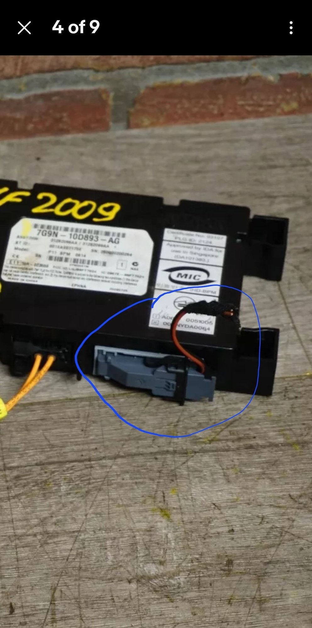

Hi jag gang quick help. Had my car for like 10yrs now no problems but I think the water thing happend and I got everything back working except my infotainment the screen won't turn on and when I try to put a fuse in the bcm it blows right away.
where does this wire go in attached picture
Where does this go?

The wreckers who took the unit out of the original car have just cut the harness instead of unplugging it; hopefully you haven't done the same? If you flip up the black lever thing and unplug the connector, you should be able to plug your connector into the BT unit. If, like mine, your connector has corroded, you can graft that connector onto your harness. It's all there under your seat.
yea my uncle said it just brokewhen he was trying to replace my Bluetooth module. But now I don't know where the wire leads to so I can solder them back. Thanks for help really appreciate it
