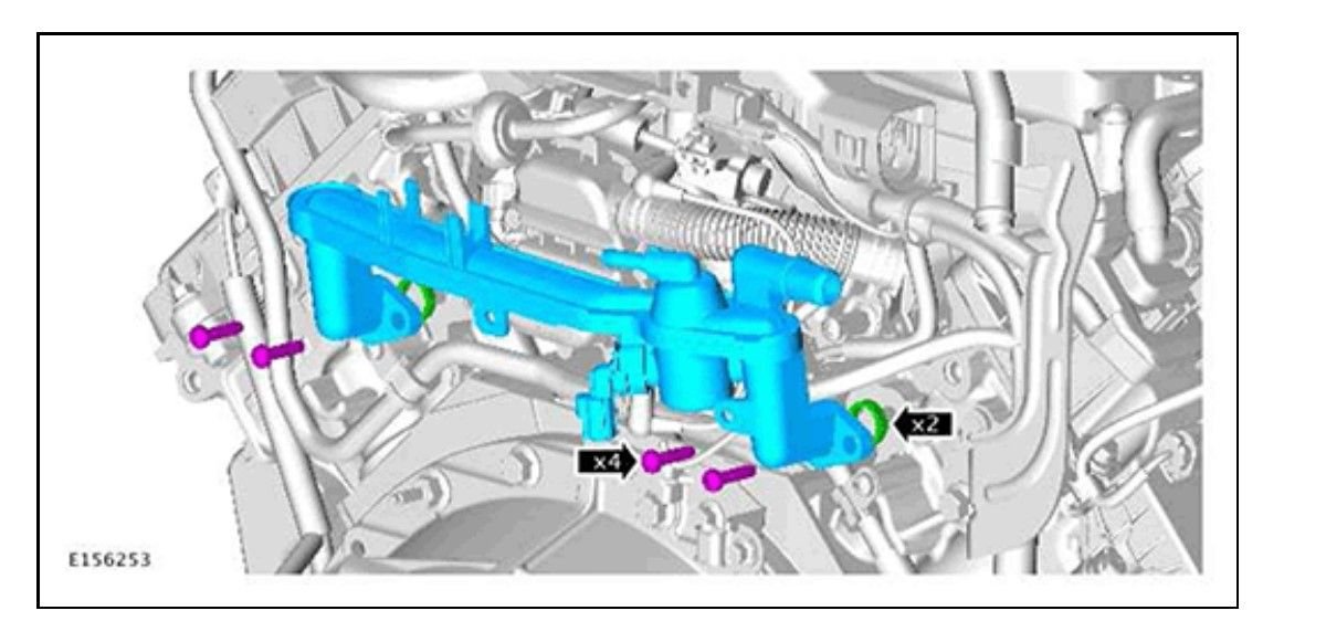

You can remove the rear crossover coolant pipe without removing the intake manifold. On the XF 3.0SC.
I would not say it was easy thou.
Handy if you have the hands and arms of a 6 year old, and double jointed.

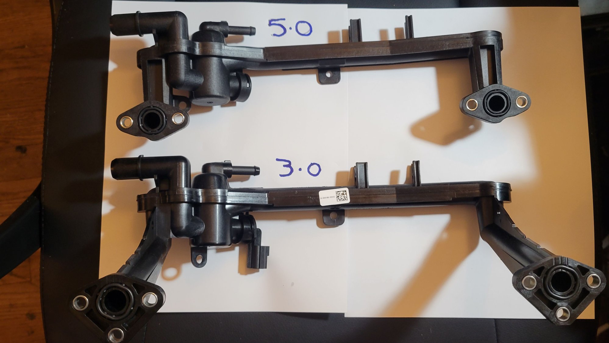

The Aj126 (3.0) rear cooling pipe having a 3 bolt manifold connector, and the Aj133 (5.0) having 2 bolt connector stubs.
The trick is to use a mirror to see the bottom 30 torx bolt head when trying to fit the drive bit for removal.

Its been a while but as I recall, the bad part was those torx screws. With most any arrangement of ratchets and adapters that the common person is likely to have in their tool box, you can only unscrew them so far before running into the firewall (or heat shield or whatever was behind it, I'm getting too old to remember details). You've got to have something like this very thin flexible bit driver or its just not possible and even so, keeping a torx bit engaged at extreme tool angles was a bear:
Flexible Bit Driver Flexible Bit Driver
I'm sure to some Jaguar engineer designing an engine without any idea of what kind of car it was going to be installed in, those torx screws made perfect sense, but another example of an engineer I would have fired on the spot. When I reinstalled mine, I went to the hardware store and bought some ordinary hex head cap screws (no flanges), flat washer and a lock washer. The next poor slob who has to do the job again in another eight or nine years when the new PA66 nylon degrades will have it much easier as he will be able to just use a Sears Craftsman 1/4" drive flex ratchet with a 10mm socket. The hex head will retreat into the socket as its unscrewed and come loose just before hitting the firewall, plus it will stay positively engaged without the need for Houdini-like dexterity.

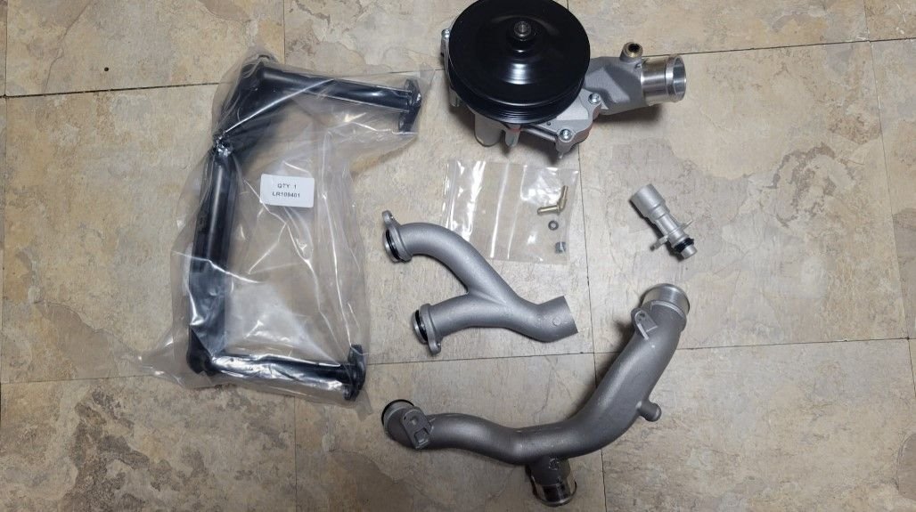

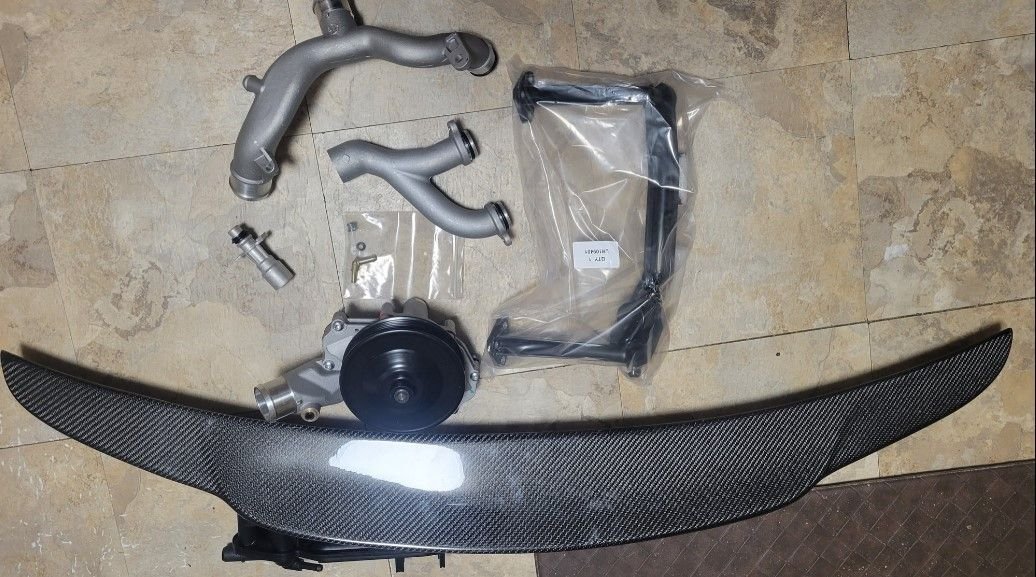

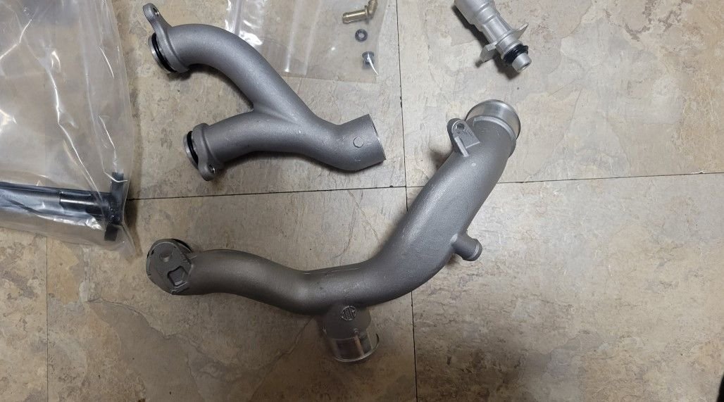

ill be doing a install video for all the plastic parts to metal and replacing the rear crossover pipes ,you don't need to remove the supercharger
