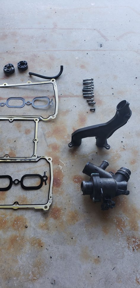

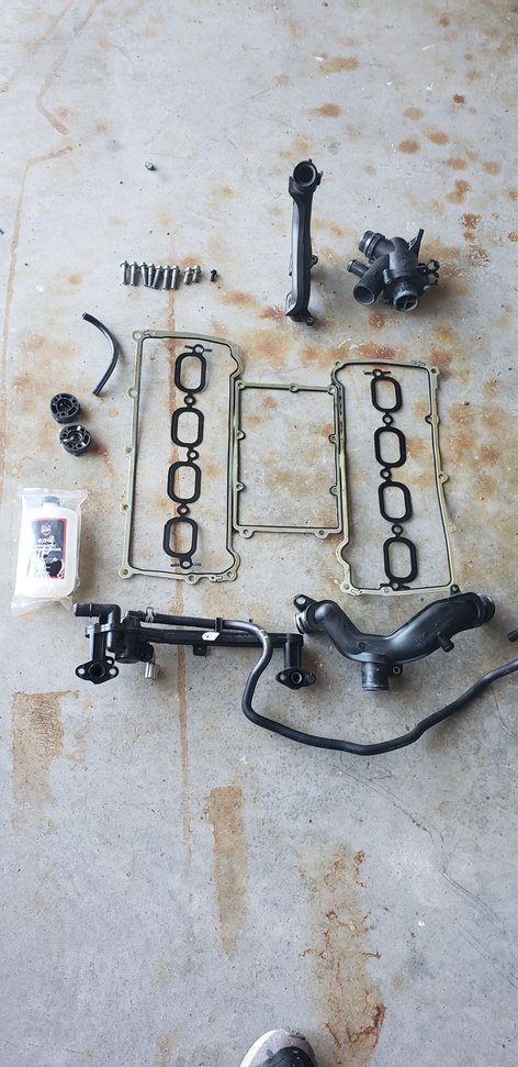

As the OP, last year I replaced both front and rear pipes, as well as every plastic pipe and tubing, all manifold gaskets, thermostat etc. Most parts looked like new ( other than the front crossover). All original parts were returned to me. My car had less than 15,000 miles at the time. I have since felt at ease when taking longer trips but still keep an eye on the reservoir level. PS. I had Jaguar do the job as I couldn’t find an Indy I had confidence in.
