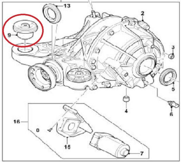

Looking at replacing a load of parts on the my xfr 2011. On the rear, where the diff goes into the subframe, you have the bushes. I contacted my local Jag supplier, and they said those only come with the subframe itself, and they can't supply them individually. Does anyone know where I can purchase these bushes from. I believe there are 3 in total, two highlighted in the picture and one towards the front of the diff.

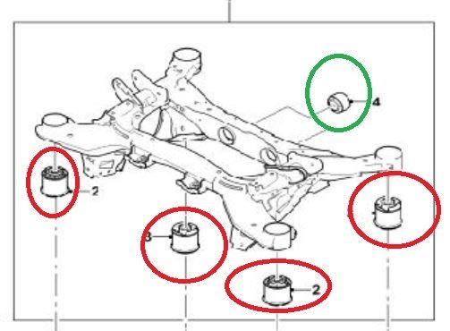

Those are not the subframe bushings. Those are the differential to subframe bushings.
Here is a diagram from JPART that show what goes where.
The red circles are the 4 subframe bushings. The green circle is the 2 differential to subframe bushings and I find again in JPART that they list them separately?
You need C2P17594. Fairly cheap at $35 each from JLR and they are good current part numbers. Should be easy to get?
Note the diff bushing in the front is way different and will be a different part number as well. It looks to be a 2 piece bushing of some kind.

No mention of VIN in JPART but do check these numbers with a dealer BEFORE ordering. I also see no superseded part numbers either. I did learn there are front and rear sub frame bushings as I had assumed all 4 were the same.
Part numbers.
One thing I found is if your interested the XFR-S uses the same front part number but the rear bushing is different. T2P1370. Don't know if you want to try that bushing or not?

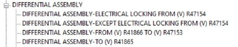

The front rear diff mounting bushings are confusing and do reference the VIN. So there must be some differences. As posted above all the rear diff bushings have been the same for decades.
Can you post the last 6 digits of your VIN? Then we can see what comes up.

Here are the last few digits from the VIN. AMR48983 I'm located in Dubai, not sure if the VINs show up in all the systems. I know it does have the e-diff as many years ago i had a fault with it. My supplier in the UK said the bushes don't show up when he looks up my VIN, which is why he didn't offer them. If you need any pictures or any other info i can get it to you. This VIN is the one from the windscreen, is there anywhere else i can identify anything that helps ?

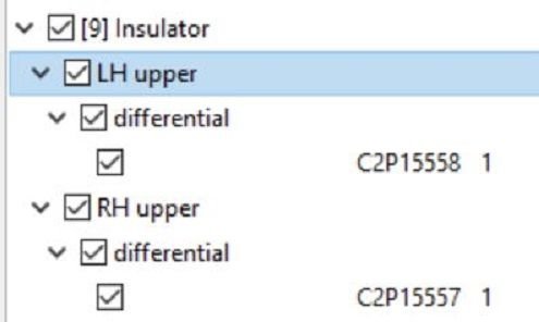

Yes thanks for the VIN. Using that I find these numbers.
I guess that bushing just mounts from the top and there is no bottom half.
Good news is they are valid part numbers and are available at any JLR dealer and they run about $30 each.
Not sure how difficult it will be to get them where your at?
