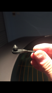

The round bit you can see is a plug. You can lever the whole thing off with a small flathead screwdriver. Don’t damage the plug as the replacement fuel cap doesn’t have it. I’ve attached a pic of the part after you remove it
Attached Thumbnails Replace Gas / Fuel Cap-a96ff04a-8525-4854-bfce-7065c16e5c2d.png
