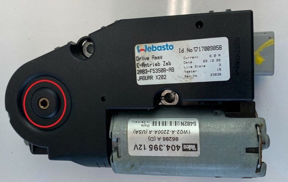

You can manually close the sunroof with an Allen wrench in the center of the motor

Good point on how to manually crank the moonroof open and closed.
Here is the S-Type motor and it should be the same as the XF I think?
Fantastic! I think I knew this but had completely forgotten. Hopefully that will make it much easier. Thanks for the info.

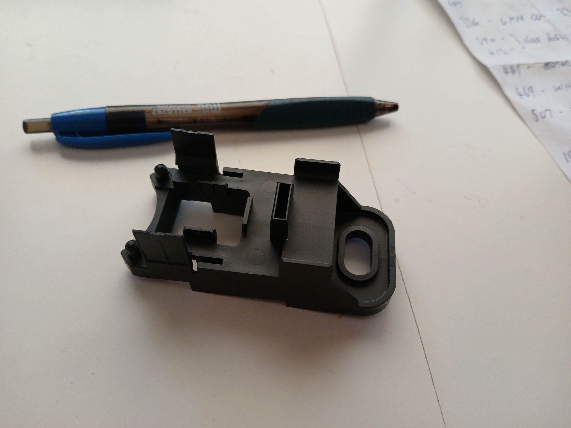

I have one leftover component that I can't find a home for, wondering if anyone recognises it? I've looked through the relevant sections of the workshop manual and can't see it in any of the diagrams.

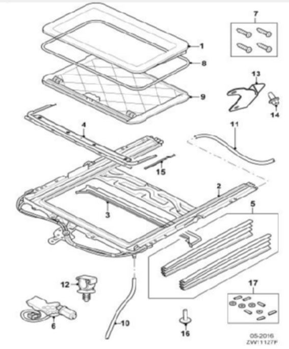

I don't see it in the parts diagram either?
If one of those parts are it. Give me the number off the diagram and I can get a part number?
Any chance it could be from something besides the Moon Roof?

I suspect it's supposed to live somewhere around the front overhead lamp unit or the rear-view mirror, it had fallen out as i removed the headliner shell and was in the front footwell. There was another part that did this also but it was from above the sunvisor retaining clip so it had a pair on the opposite side that showed me how to orient it. This looks like it goes somewhere central.

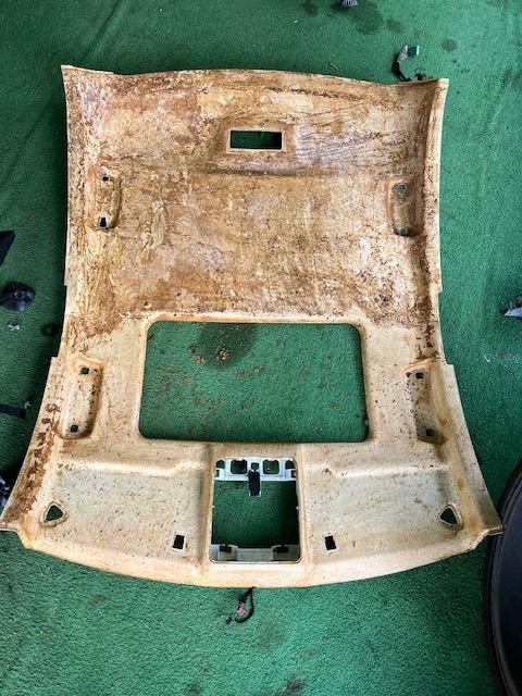

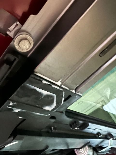

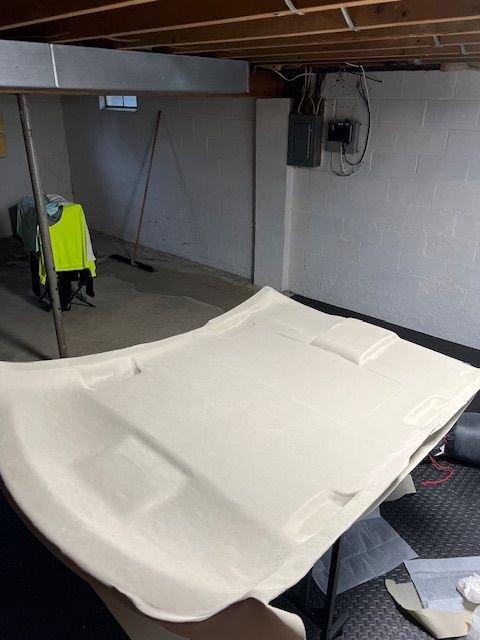

Nice! I just did this last summer on my 2010 XF. Had a leak near the sunroof and had a slight crack in the plastic trim for the sunroof I had to calk. I just bent the headliner slightly and pulled it out of the rear door. I didn’t want to bother removing the windshield even though technically that’s how it should be done.
