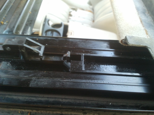

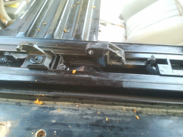

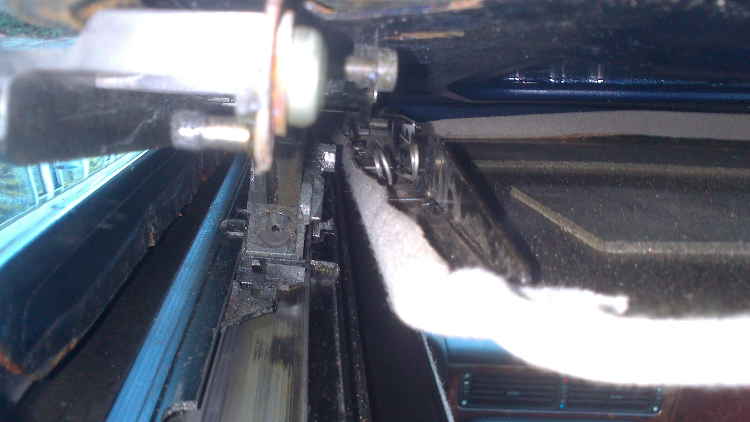

Took everything apart the other day and discovered there are some broken clips that hold the interior panels
Still cant figure out what connect to what even with the diagrams.
can I order them?

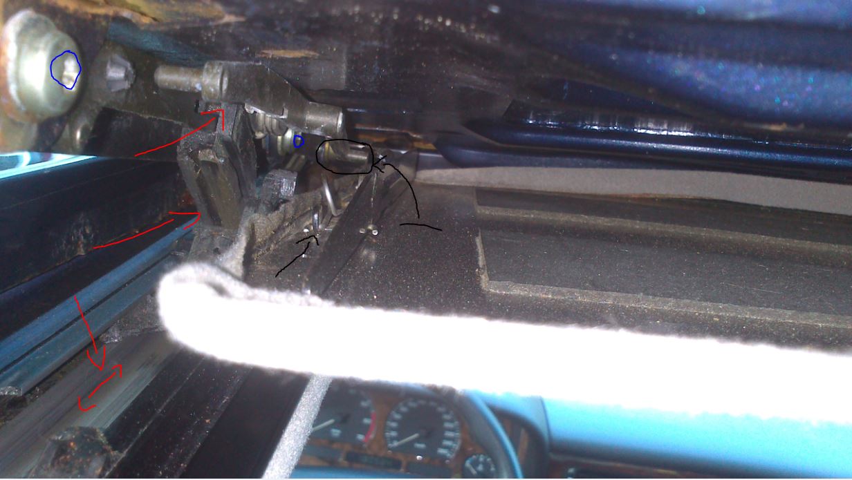

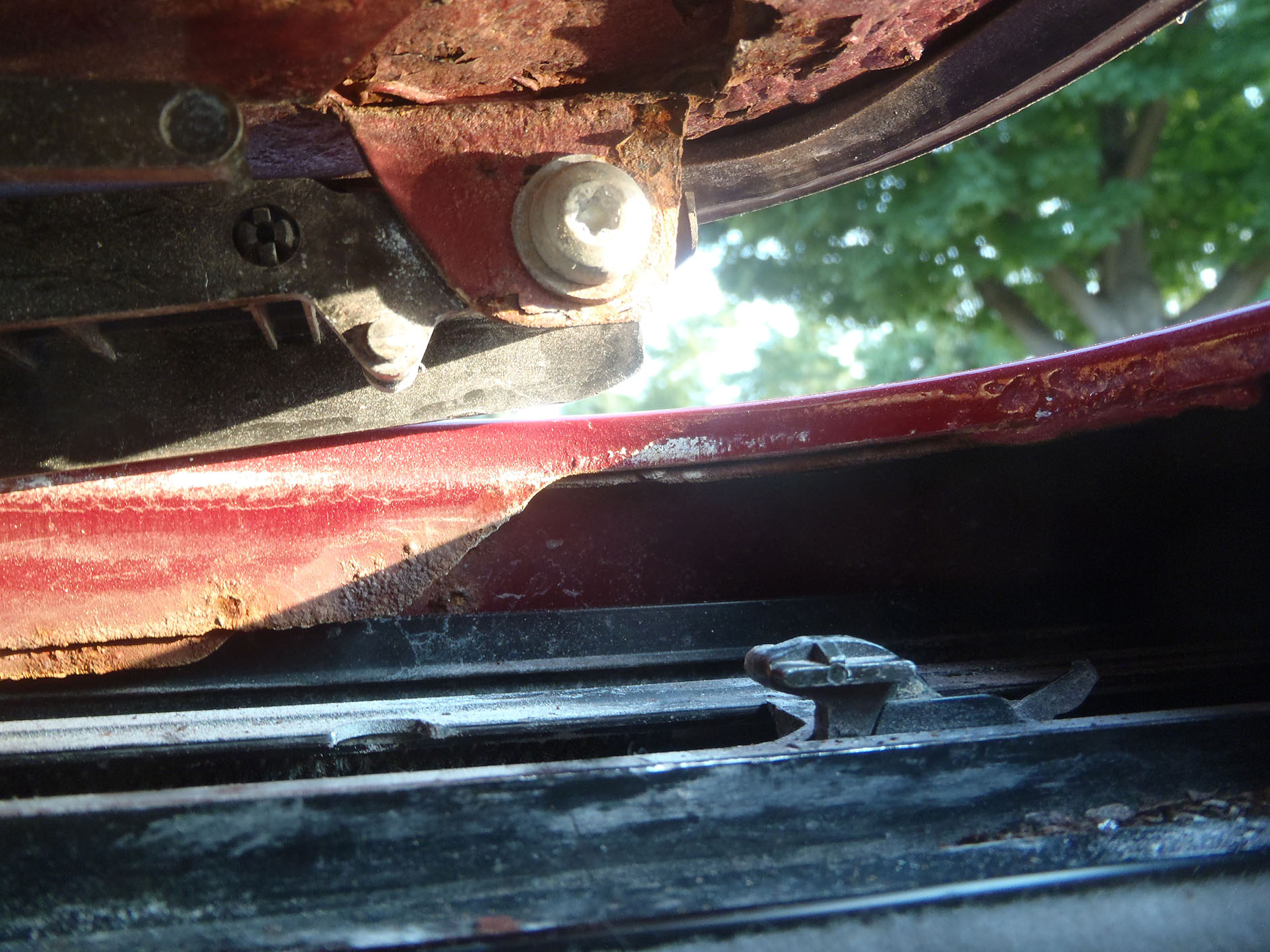

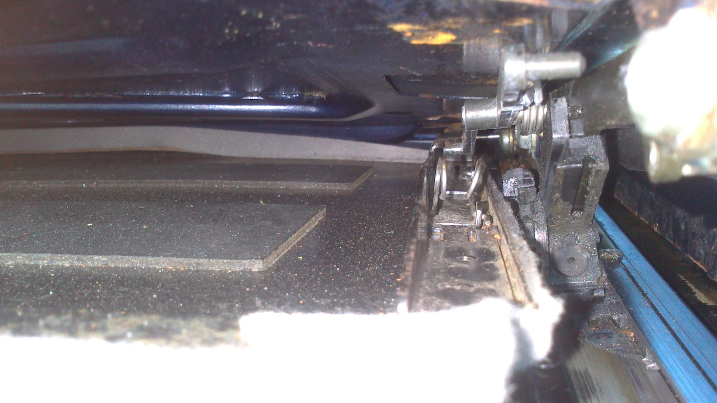

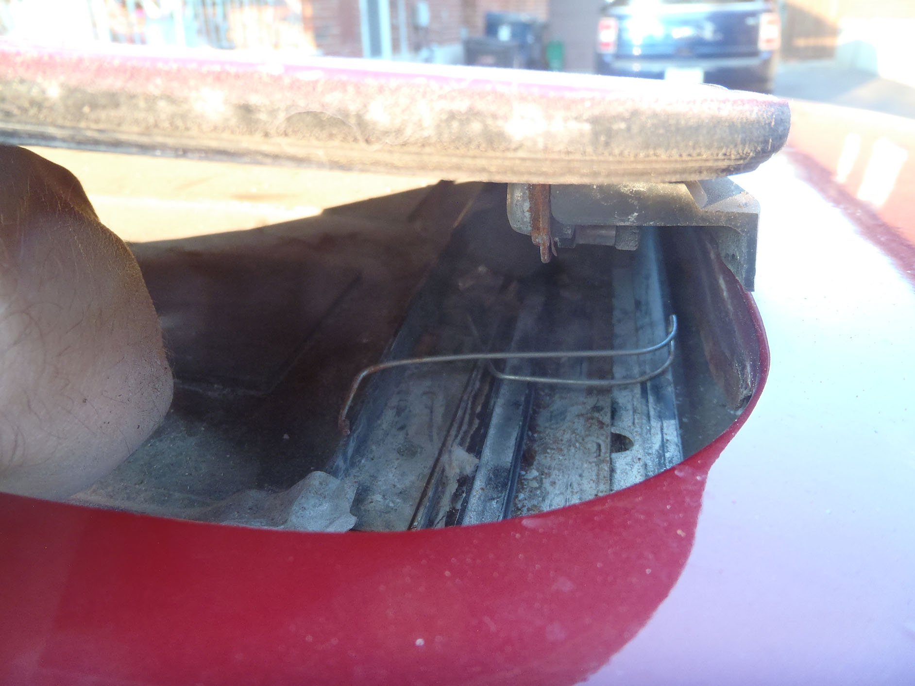

When I see your post I ran outside to make some photo's for you from my roof assembly. I didn't want to pull anything out because my panel is just as fragile as others! ;-) Anyways I hope it helps you sorting out your sunroof.
I edit one picture for you, the black markings are for the inner panel, red for the mechanism and blue for the roof itself. Check the clips that hold the interior panel and compare them with yours.

Thanks So much Maraud you're a good man! This will definitely help me sort out my sunroof issues for sure. You're the best. These photos help soo much its very nice of you to go through all that trouble.
