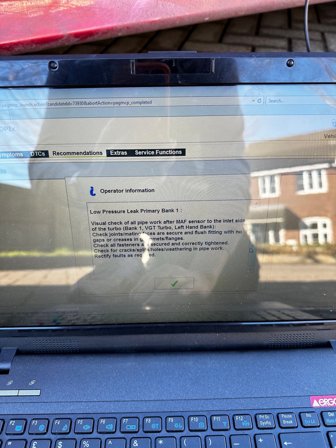

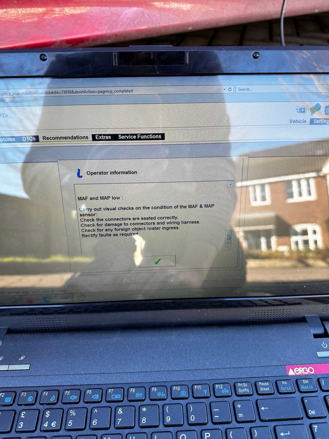

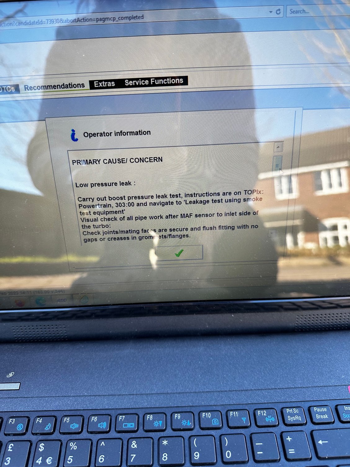

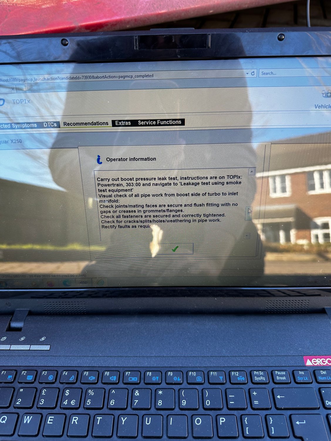

I've since had it on SDD and there are no corresponding fault codes. Only one for rain sensor, rear door lock (waiting for part) and that's it. I ran a recommended diagnostic (can't remember the name) that tested the engine in idle and then I had to rev it to 3700rpm and 4200rpm for 30 seconds each. It came back with low pressure leak asking for a smoke test etc, please see pictures. I'm going to do a smoke test on it but was wondering if the reported oil leak and the low pressure all have something to do with this strange issue?
