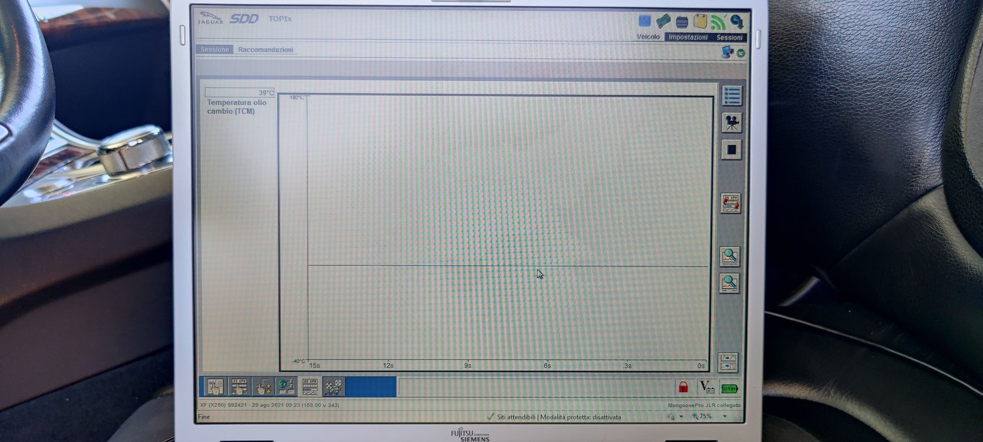

ok! this morning I found in the sdd the page to check the oil temperature of the zf8hp. post the photo and thanks for the tip.
Oil level carried out successfully.

I see your battery symbol is yellow? Needs to be green or bad things can happen. Since you are merely monitoring stuff you should be OK.
Since it's in Italian I am not sure where that is in SDD?
PS; I see your SDD has been updating successfully too! Good job! 159.00 V.243 right now.

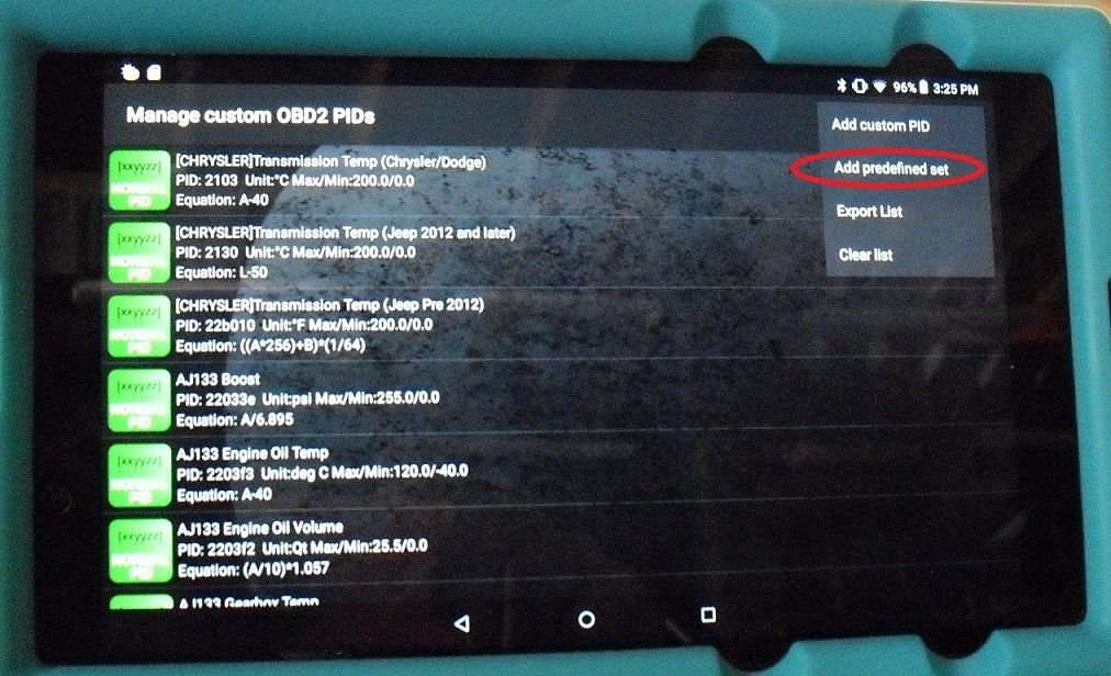

Just to add to this. Torque Pro has the ability to add Custom PIDS. I added a pack for Mercedes E-class so I could read the transmission temperature on my tablet while working under the car on a lift. This is VERY convenient way to watch the temperature hands free while your trying to put the plug back in!!
Here is the custom PID screen in Torque Pro. Note I have the special Jaguar PIDS also.

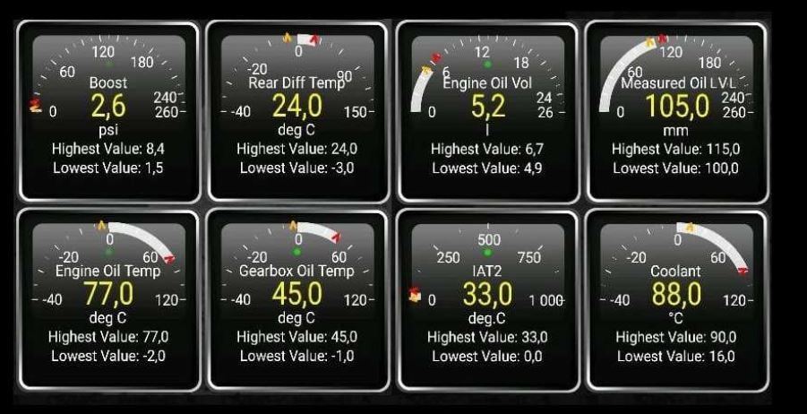

We also have this for our Jaguars but I have had trouble getting it to work and I am really more interested in the IAT temperatures for my tune and blower pressure.
Here is the what the dash board looks like for the Jaguar PIDS. Note the transmission temperature. I have these in Imperial units too.
I have attached instructions to add these PIDS if anyone wants to try them out.
