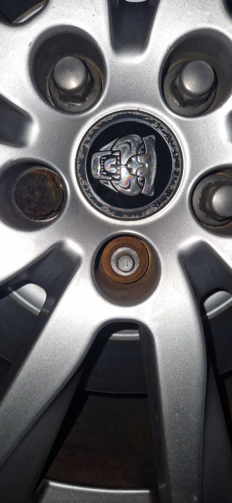

Hey everyone,
I’m looking for some advice on how to remove a snapped wheel nuts from my car. As you can see in the attached photo, the nuts have sheared off, there’s not much left to grab onto.

Use a screw extractor set. Drill a small pilot hole into the broken stud, tap the extractor in, and back it out with a wrench. If that doesn't work, you'll likely need to drill it out completely and re-tap the hole.
