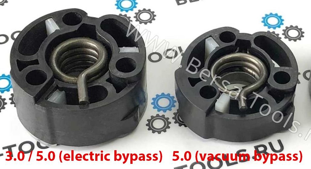

Are the early vacuum chargers and electronic actuated chargers' couplers interchangeable? SCOL says this coupler is only for Vac
If they are different, anyone have a source for just the oem coupler for the later electric actuated 5.0L unit? If not, I am assuming there is a part# for the snout kit (also for electric)
The 5.0 electric shutter blowers use the same coupler as the 3.0 electric shutter. On 5.0 motors with a mechanical vacuum damper, a different coupler is used.
I'm intrigued by this - I have a 5.0 with the mechanical vacuum bypass, but why would it use a different coupler? The one I fitted looks the same as all the others. The coupler is just joining the hubs on the end of each shaft in the snout, it's not really got anything to do with the bypass valve, which (AFAIK) just opens a flap to allow air to bypass the slow-spinning rotors at idle.

The only thing i can figure is the vac one is snappier and goes into boost or bypass instantly needing a little cushion, whereas the electric is smoother and not such a blunt force. I would be curious as what gear set is in the tvs
The only difference is in size:
The picture from the Internet is for comparison only.
