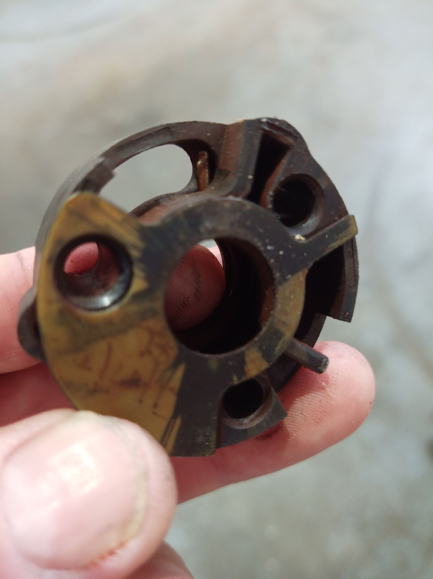

One problem with the OEM design is that the spring will wear the shaft.

I wonder if that's why the modified the coupler and added a metal reinforcement to the end of the spring capturing it. Trying to keep the end of the spring from contacting the shaft on the snout drive?
The metal is there to stop the end of the spring breaking through the plastic and therefore losing tension.
End of spring broken through at top. I had two like this.

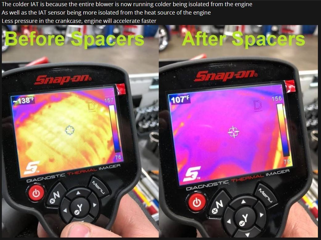

I have run into heat soak at the stock level on track.
It pulled so much power that on a short oval track instead of hitting 82mph, I hit under 60mph and lost my last race to a f-body.
Of all the things Stiegemeier sells its the Venomcooler is the part I want to buy from him. Its a cooler to cool the heatsoak on the supercharger itself - not interfering or to be confused with the intercooler. Coupled with an interchiller that runs on a separate 12V electric a/c compressor, and a blower spacer, I think the heatsoak can be fixed. Adding more heat exchangers under the hood would be a losing battle considering I can't drop a quarter in the engine bay and have it hit the ground. No air flow. The last thing that will work is water injection kit, that will drop the engine temps by over 60F instantly when you need it most. That nifty blower spacer can house the water inj, and keep this car cool in 100+F weather. Hopefully anyway, those are my plans to knock this heatsoak on its @$$. Eventually a better intercooler setup and bigger blower will drop temps ~15F and allow for 29% more CFM flow. Running E85 can drop temps 40F. Running a pyrogel blanket under the blower can drop 10F. Ceramic coating the blower housing can drop 10F. Every bit adds up.
