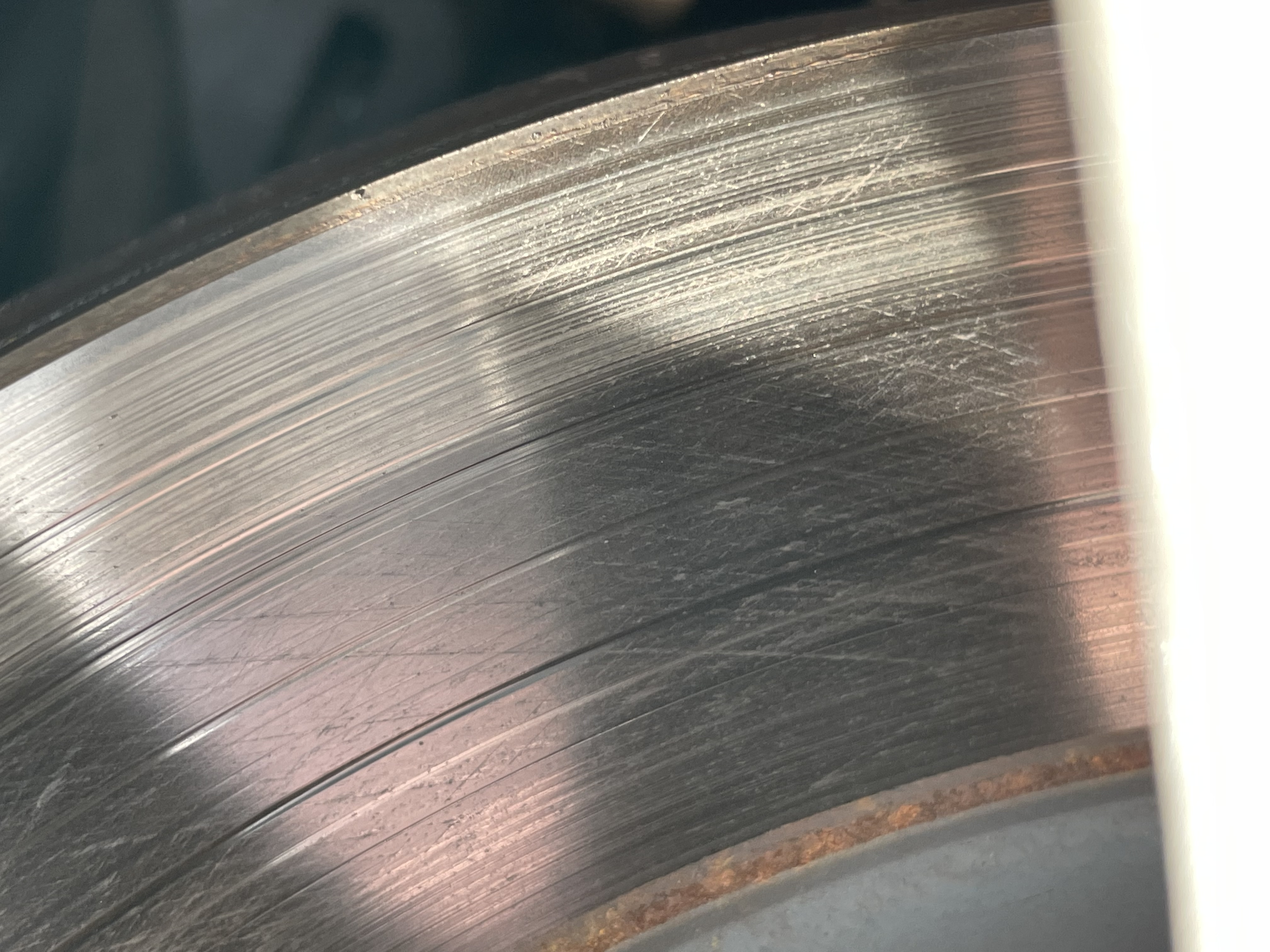

Pics coming up! But a sticking brake wouldn’t cause issues at idle. So possibly multiple issues?
Been seeing reports of cracked exhaust creating the vibration and noise I hear between 12-1500 RPM.
EDIT: Attached images of rotor and tach within the RPM range.

It is all very strange, isn't it ? I also can't see how the control arms could give symptoms at idle unless they were basically broken into bits ?? Dunno. Yeh, I agree - that should have shown up with even a cursory "wiggle" .
Is this the same mob that did your brakes and rotors ? I'd be a little concerned if it were me. :shrug:

No, a different shop thankfully. This is the shop I bought the tires from. They balanced multiple times, rotated, aligned, warrantied out front tires for more expensive ones, and did this last inspection which clearly was more thorough and found the suspension stuff. The asst manager got his master tech to look at it finally and thats who found the bushings. The shop has been great so far, aside from clearly not doing an in depth enough inspection*.

1. Damage to rear rotor?
2. "Also have aligned everything, new tires, had the rims checked for trueness, mechanic sees no issues with anything.. " I just replaced front and rear control arms, tie rods, stabilizers etc.. on the 2010 XF (Lots of fun ripping apart all the top components of the front as well as access to the back for the struts/shocks removal), funny how the alignment is done but only now noticing control arm issues. How could the alignment be done in the first place?
3. "Had a power steering flush as the fluid was black and burned" How much damage was done to the steering pump?
I would want to find out why there is the wear on the rear rotor, how the car was aligned in the first place with the damage to the control arm bushings, look into issues with the steering pump and then start looking elsewhere. I would also check for the tells on the tire/tyre wear.

Rear left rotor has 2-3 moderately deep grooves yes, I plan on taking it back to the shop who did them.
