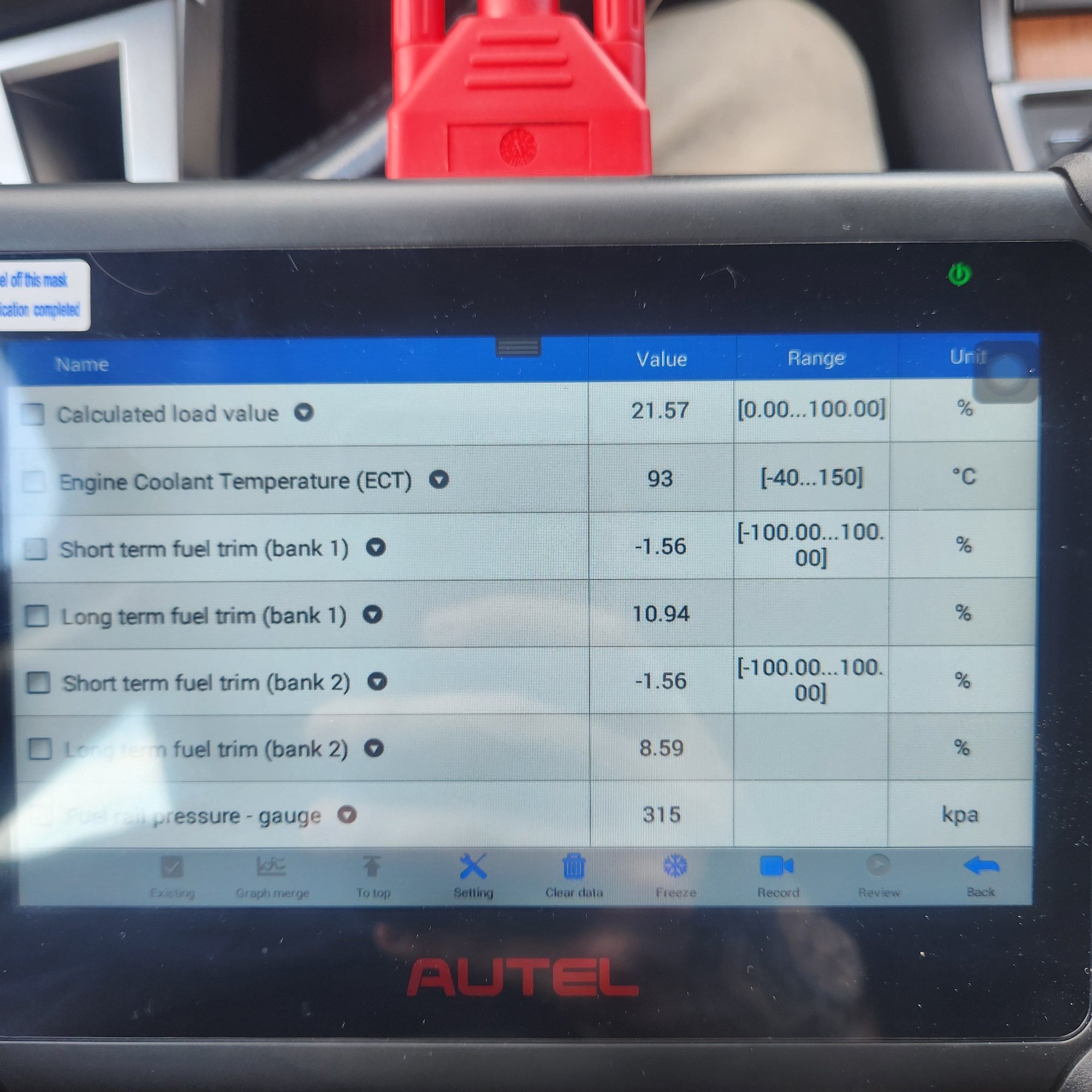

Recently replaced etc, pcv hose, and fuel pressure regulator, I've been monitering my trims and after a good several hours when I go to park my bank1 ltft is about 8.4% and bank 2 ltft is at 9.4 at idle.now this was after driving for several hours to monitor the work I have done. When I'm driving with rpms around 2000 I'm seeing pretty consistent trims even zero across the board for short periods. Now I'm wondering if this could be consequence of engine wear or a possible dirty maf sensor or even dirty injectors?

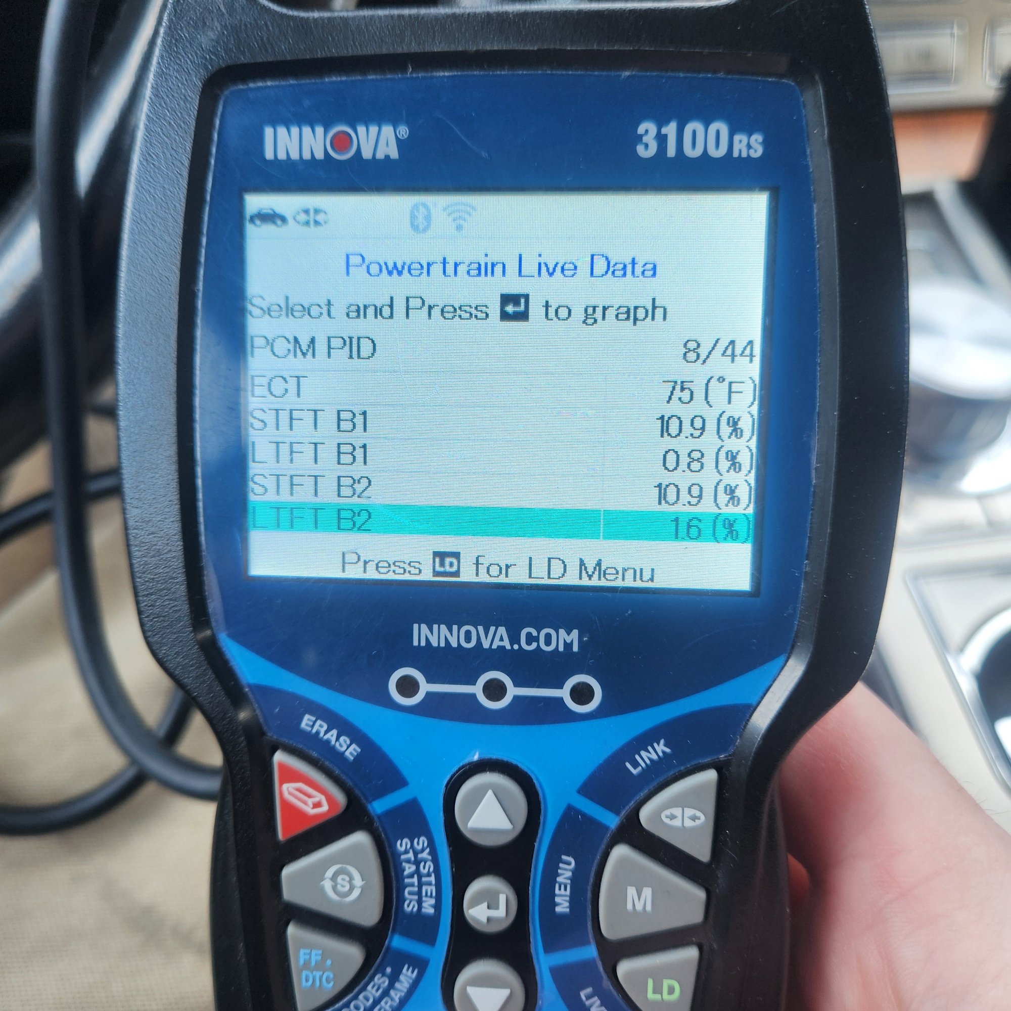

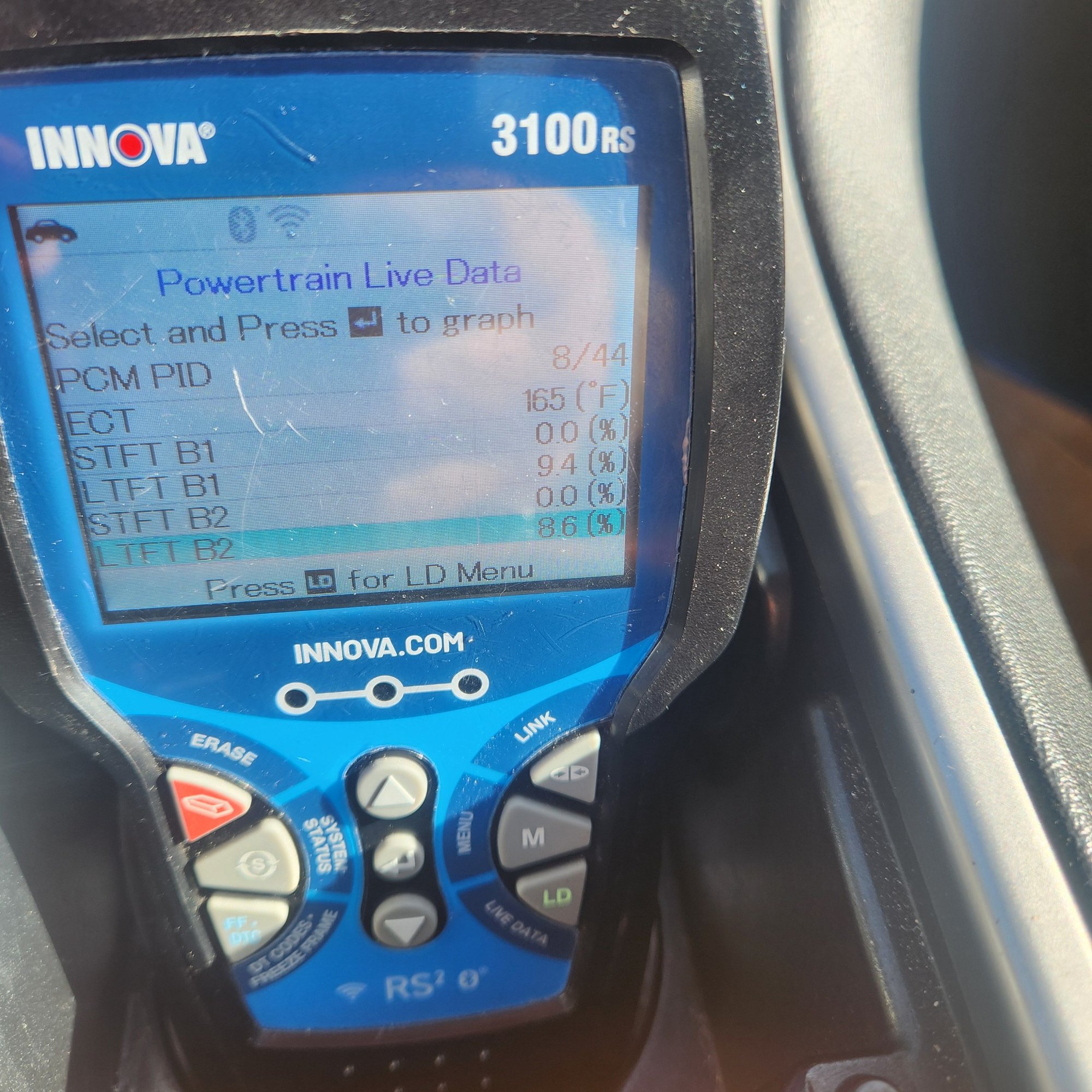

So started up I have cold readings and after readings. Seems my short term is starting excessively high then switches over to high long term at idle.
Right on start up
Right on start up
Now at idle...
Now at idle...

AFTER SHUTING DOWN stft bouncing around but slowley rising
AFTER SHUTING DOWN and restarting stft bouncing around but slowley rising

Idle 30 minutes roughly now.
