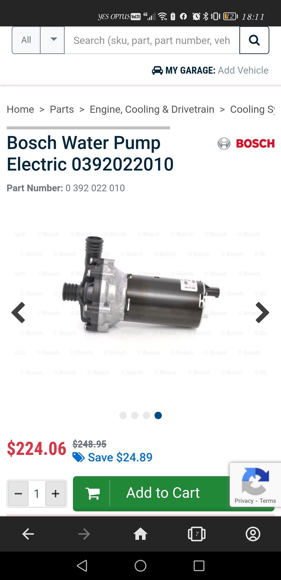

Want to make sure this is the right one before I purchase it

Youre in australia so I hope that price is equivalent to $130 us. Or else youre getting ripped off. But the number looks correct
