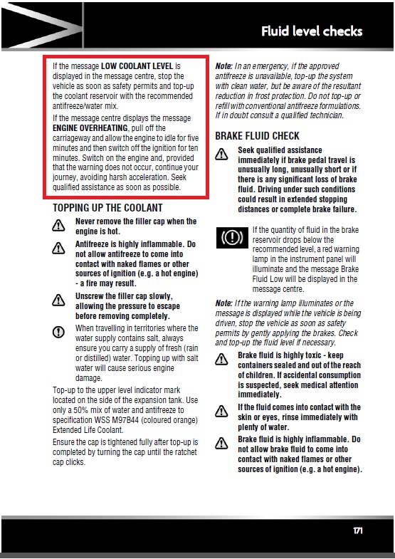

Originally Posted by b.marsella
................ Is their something in the 2011 xf owners manual to tell the owner if the low temperature light comes on pull over right away the car has overheated???
See the section boxed in red:

Opps, a Problem..we don't have carriageways in the US...Now what?

That "carriageway" term seems a bit archaic even for UK English usage! Seems like "motorway" would be the more contemporary term. At least Jaguar remembered to edit out the part noting that you should take care to avoid horses while pullling over...

A Motorway is a dual carriageway. However, some A roads are also dual carriageway but not a Motorway. The phrase means the same thing as a divided highway, also sometimes called a Freeway, or even an Interstate, in the US. The English use Motorway to refer only to a dual carriageway meeting British motorway standards which, BTW, far exceed US standards for Freeways and are much safer as a result.

Looks like Jaguar does have a temperature gauge after all, it just stays invisible until the driver needs the information. Then it informs the driver BEFORE the engine overheats. Seems pretty good to me.
