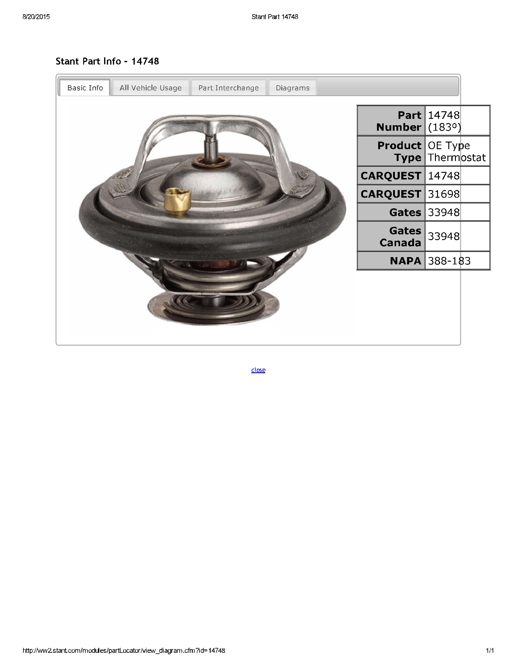

I ordered a replacement thermostat off of Amazon - Stant #14748. It looks nothing like the OEM. The Stant website also shows this unit as a fit although their part cross reference to the Jag number is wrong.
I also noticed that the one of the shoulders that hold the OEM thermostat in place is broken off. No telling where that piece of plastic ended up.
Has anyone used an aftermarket?
Check out https://www.jaguarparts.com/partscat.html
I was able to see that the thermostat part is #AJ811788. You should be able to find your missing piece there as well.
I would return the part that doesn't look like the original and buy the one shown on this site.
I let Stant know that their part was not compatible. I got, "...well that's what the chart shows....". The "missing part", it actually a piece that has broken off the plastic housing; not replaceable.
