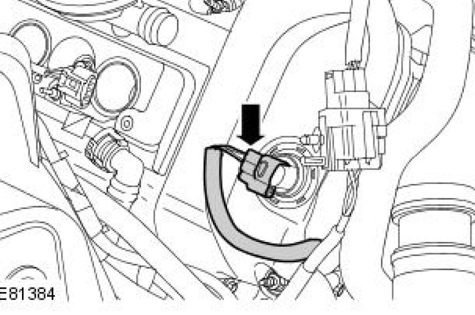

On my 4.2 xf 2009, the valve covers have a stump with 2 wires (front of engine nearest to radiator) coming out it and I was wondering just what those are and should I replace if the plug on one is broken.

I'm not sure which part you mean, is it this part?
Can you add a photo of the bit you are referring too?

The arrow in the drawing is the part I'm speaking of, what is it? Thanks
It's the variable camshaft timing (VCT) oil controlsolenoid. That needs to work in order to supply oil to the engine properly.
Not quite correct, it needs to work to allow your camshaft timing to adjust.
