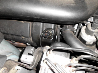

what is this sensor called, its in the middle of the picture on the end (front of car) of the valve cover. on each side of motor they are leaking oil, i have searched and not a pvc valve. cant post picture

photobucket now

Hi, 4.0 V8 I take it...that is a VVT (Variable Valve Soleniod) - there is one on each valve cover. This soleniod controls the VVT actuator, which controls your valve timing. There is a gasket for the VVT solenoid - best bet if your going to change that gasket (which requires you to remove the valve cover) you might as well change the valve cover gasket and associated spark well O-Ring gaskets as well.
