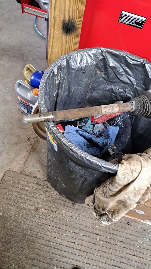

Clean snap.

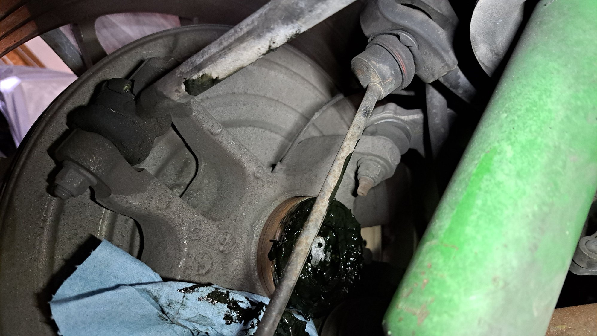

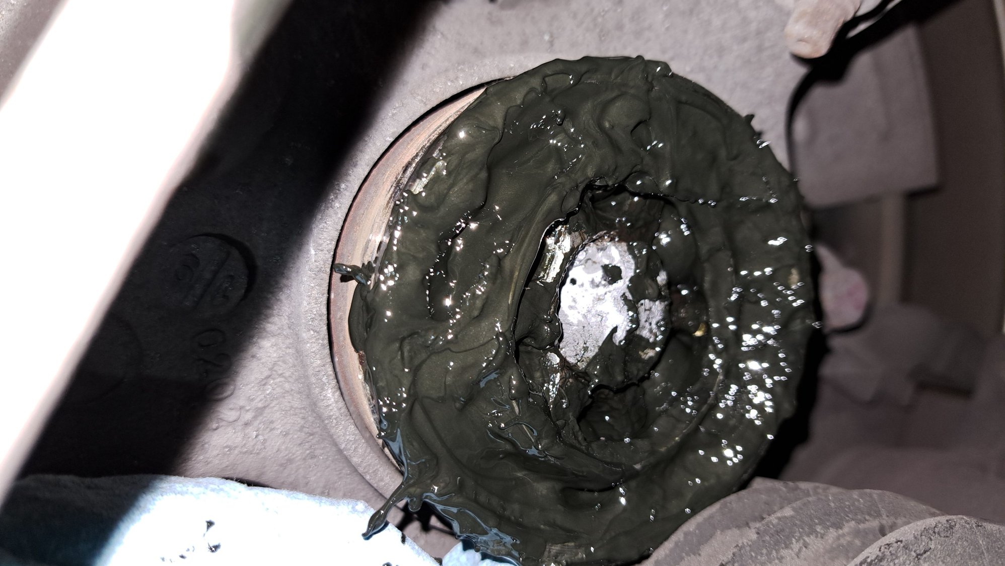

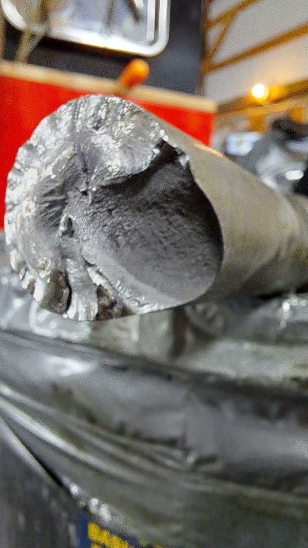

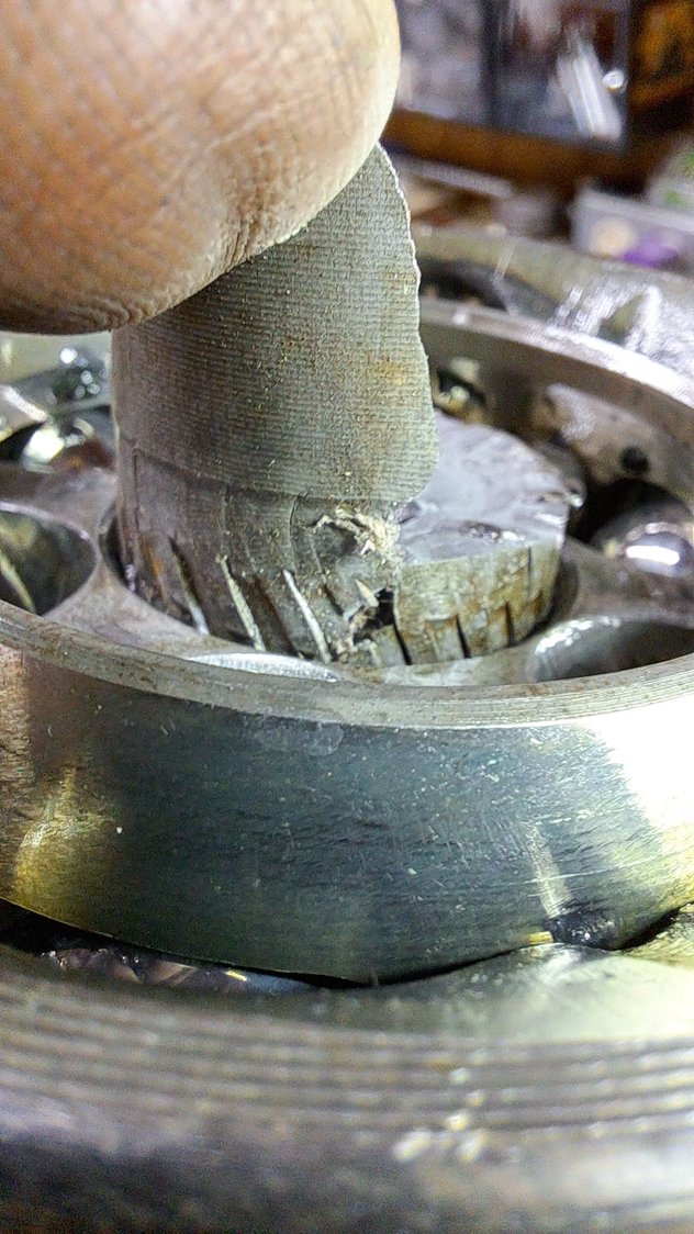

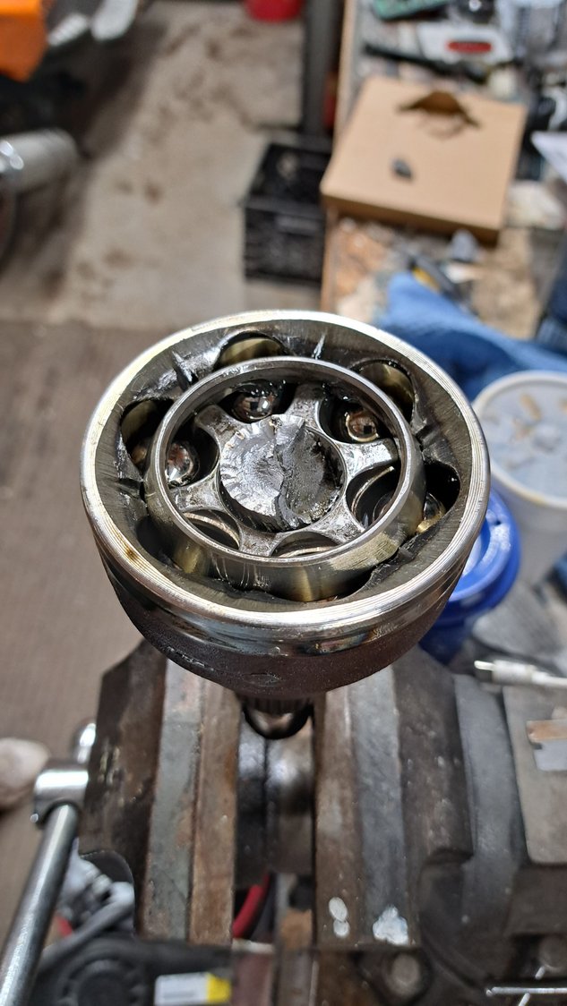

Here are some pics. Side note: I bought an axle remover and it worked very well removing the axle that I could not even sledge hammer out of the hub. I used PB Blast yesterday front and back and the axle remover today.

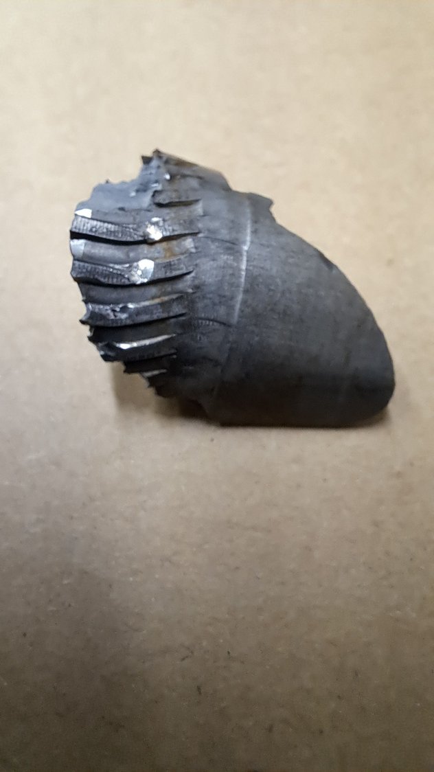

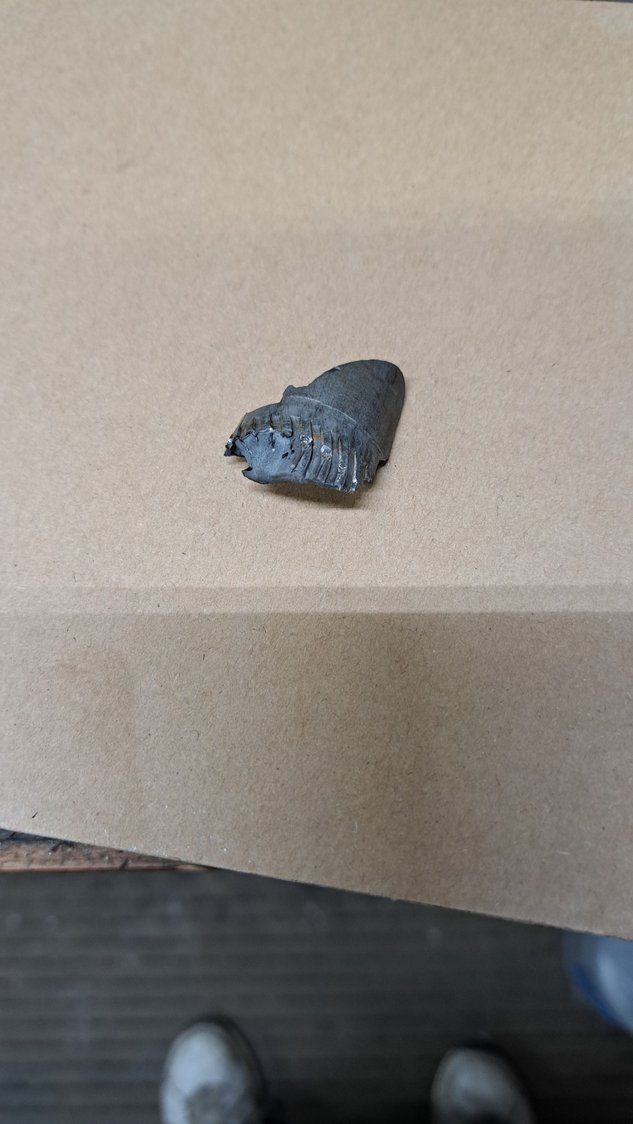

The axles are beefy until the spline part, then it steps down some!
You can see the twisting line
More twist!
The joint itself was in great shape with 114k on it.
Old Mar 14, 2023 | 07:49 PM

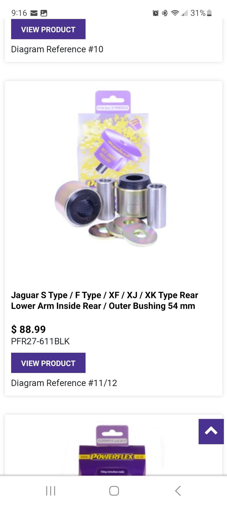

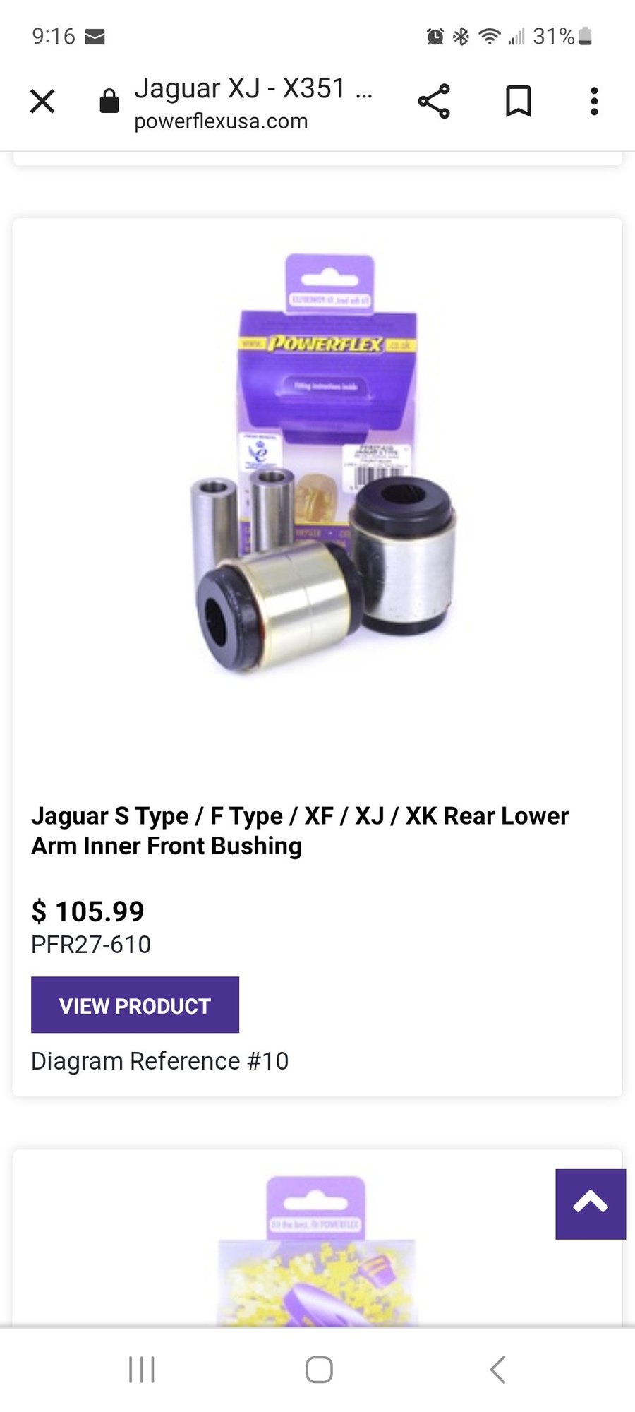

Got my bushings direct from Powerflex.
Each box contains 2, one from each side.
Some require 2 sets of #11's, but not the case with mine. I needed one box of each

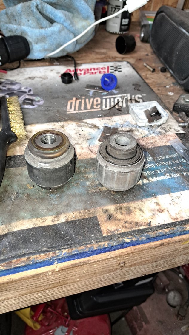

The huge #10's required me.to press out the center then hammer and chisel to "fold" the bushing out. I also used an air chisel but be careful about marring the mating area. If you do use a file or dremel to dress it smooth.
My small 12.5 ton press worked well in pressing the old bushings out and the new ones in.
Two of the old bushings i pressed out.

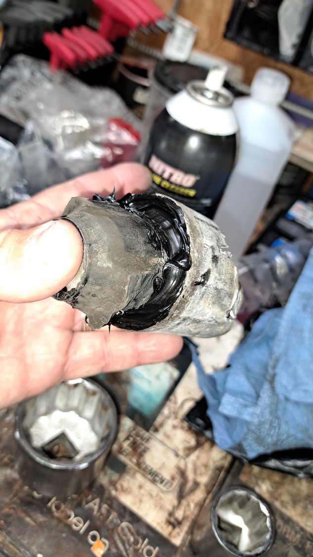

I took the old bushing that i pressed the center out of, placed it back in halfway and used the urethane that I bought to secure it back and let it dry 24hrs. It is pretty darn stiff and harder to cut than the factory rubber of the bushings. So I believe it will help the bushings that i filled in for the cradle and diff.
I bought the urethane from the local autoparts store, about $50bucks. Amazon has it for $27-ish
Hardens to 55-65 range. Several videos of using this just google "windo weld for bushings" I used it to fill my cradle and diff bushings for extra stiffness trying to reduce wheel hop.
Got my axle from ebay.

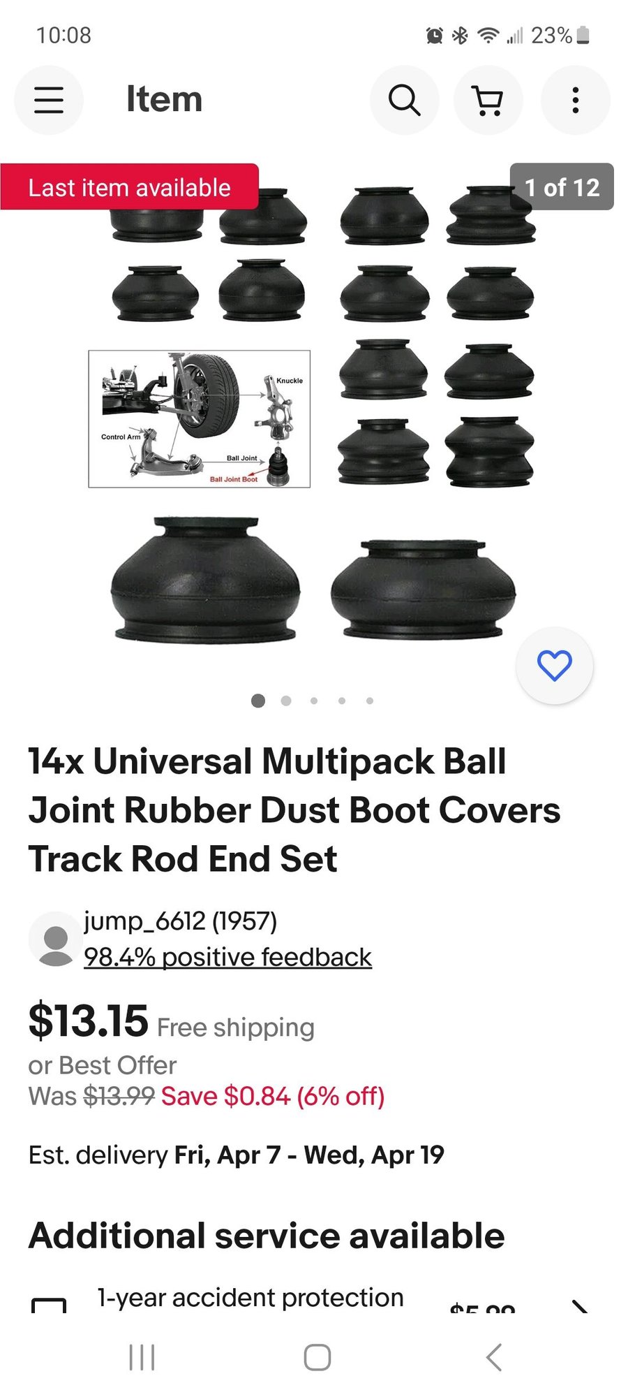

I also bought these and replace my cracked ones on the sway bar links and the tie rod (for lack of a better word) end dust covers. They fit tight enough you don't really even need to zip tie them.

Originally Posted by wimmer
one of each package is all I need?
Yes that's is all I needed. There is a disclaimer on the product that some use the 612's in 2 places, but mine did not. I used 610,611,612, each pack has 2 bushings, one for each side, and a pack of silicone grease, although I added a nice portion of additional grease because polyurethane can squeak when they get dry. So I piled it in them.best I could lol.
