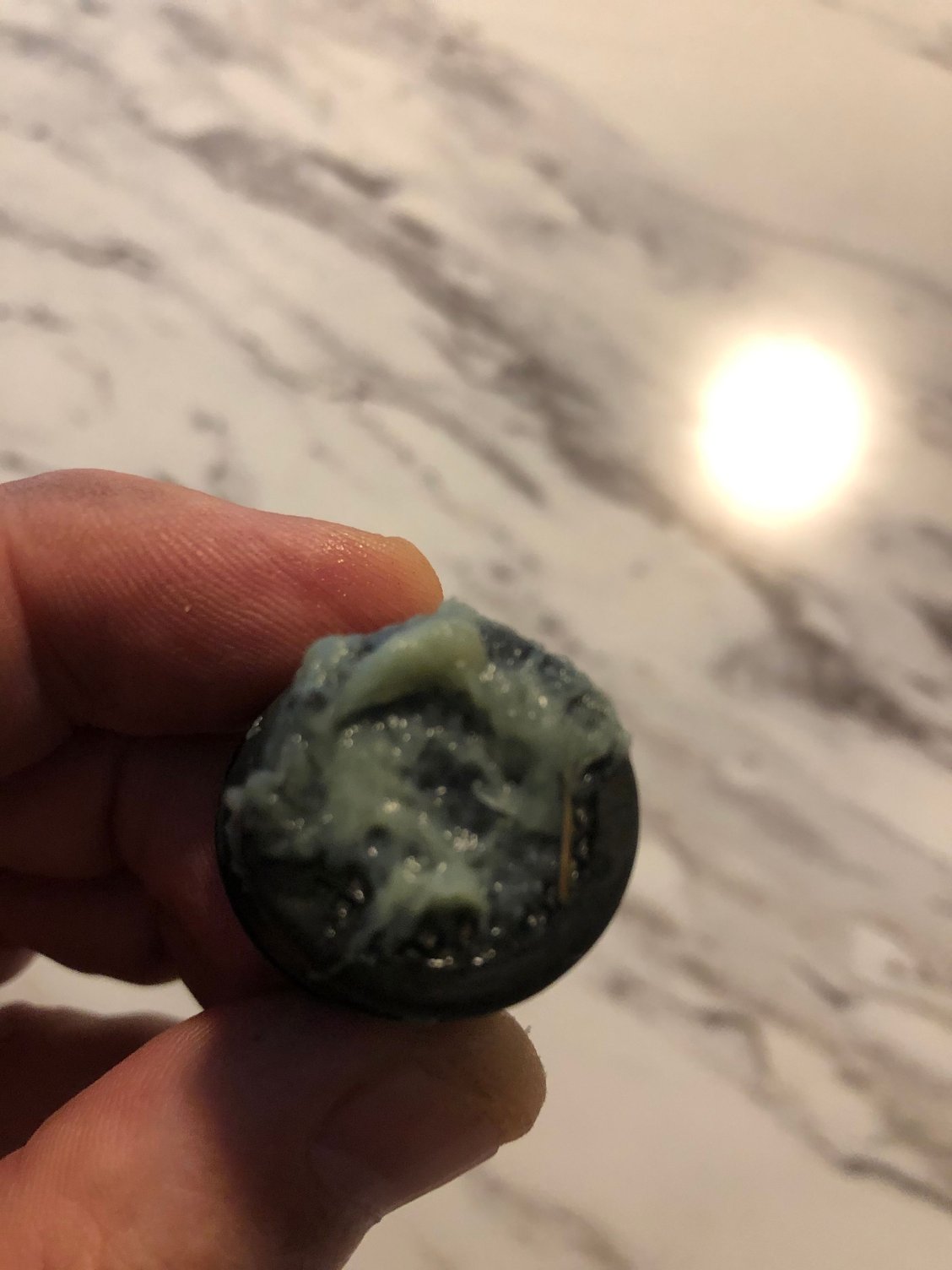

So I have had poor washer performance for months. Tried several quick fixes and nothing worked.
Decided to get dirty and pull the pump motor out from under the wheel well shroud and check the washer fluid container filter screen.
As you can see in the attached photo, that was the culprit. It was clogged so bad, nothing was making it to the windshield.
Nasty. Just nasty.

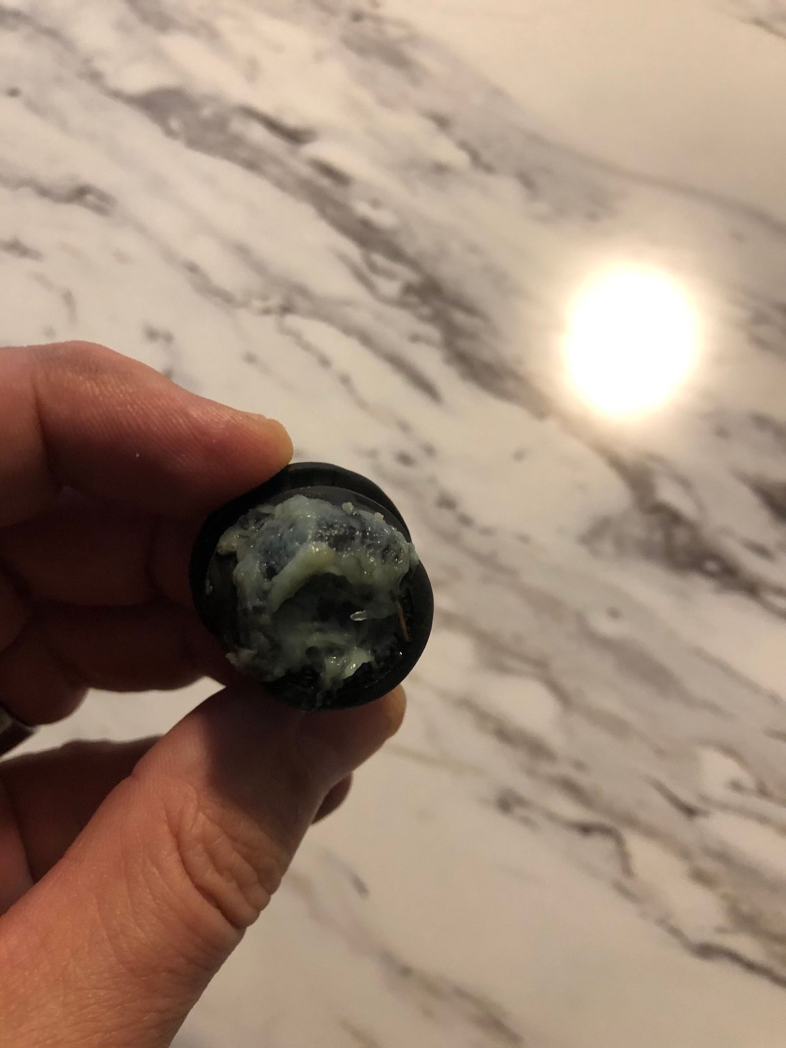

A better view of the clogged filter.
After I cleaned the clog from the filter and gave a good rinse to the washer fluid container, all is well again.
It only took a few minutes to get to the pump and filter. I didn’t even have to take the front wheel off. Just turned it so I could get my hands into the wheel well arch and pull back the plastic shroud by the washer pump.
If you are having issues with your system, I highly recommend this as a troubleshooting option.
