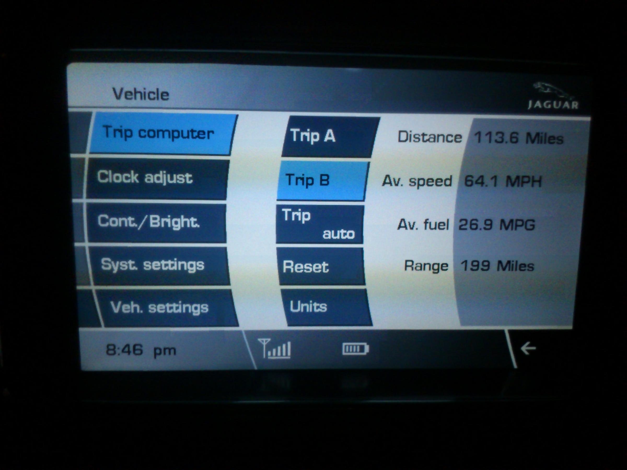

I just came back from Orlando, FL, yesterday and I am jetting off the Taipei today. I am due back in California on the 10th of March, then it's on to Toronto, Canada on the 12th...
Still no time to take the car to the Dyno... but, fuel economy seems to be somewhat improved (surprisingly). I logged this on a 110+ mile drive from Sacramento, CA to Belmont, CA. Almost 27 mpg... at 65 mph constant (cruise control) minus a few instances when I have to brake for traffic. This is the best I have ever seen since I owned the XF! I believe it may have something to do with the XF-RS programming being leaner than the XF S/C programming. Still... here it is...
