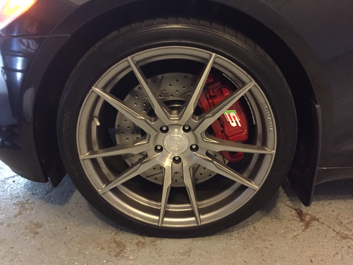

I got drilled and slotted R1 on mine. I doubt you can feel the difference in typical driving (in theory it gives better cooling) but I just preferred the look.
Mine look a bit different from eline - two rows of holes between each slot - see pics below. They are the silver ones. But I can't remember the series. Was a couple of years ago now.
Check what pads you get. Mine are post-quiet ceramic (so they claimed on the box) although they may actually be semi metallic. Overall I've been impressed. They are less grabby and smoother - but you have to press a little harder.
Think the whole set 4x rotors and all pads came together as a kit for about $700. Was a lot more expensive than the standard XF kits (bigger brakes on SC and XFR so they charge more...). Still a lot less than oem
And very little dust!
